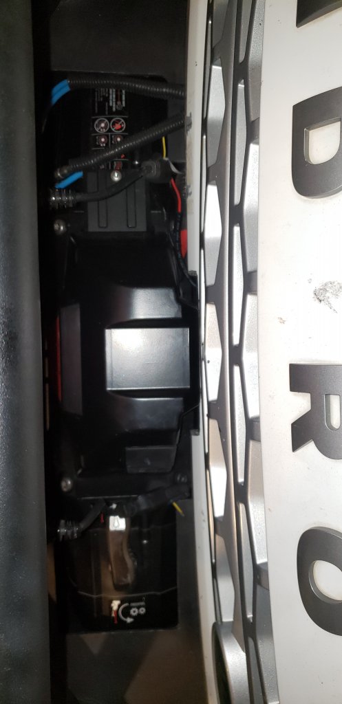

First picture shows how I had to lengthen the cutout to accommodate the winch clutch lever, as well as the notch cut out of the grill. I wish in retrospect that I had angled the corners of the grille cutout. You can only see them from one angle, but if I had angled the corners, it would be invisible.
The blue lines coming out are my air line extensions I can use to manually inflate the front struts in the event of suspension failure. These used to live behind the grille, but the cutting left me with a nice place to make them more accessible in case they are needed.
Second picture shows that I had to cut the thin piece behind the winch opening, as well as notch cut the front of the bumper to accommodate the winch. The cross-bars on the winch are just wider than the standard opening.

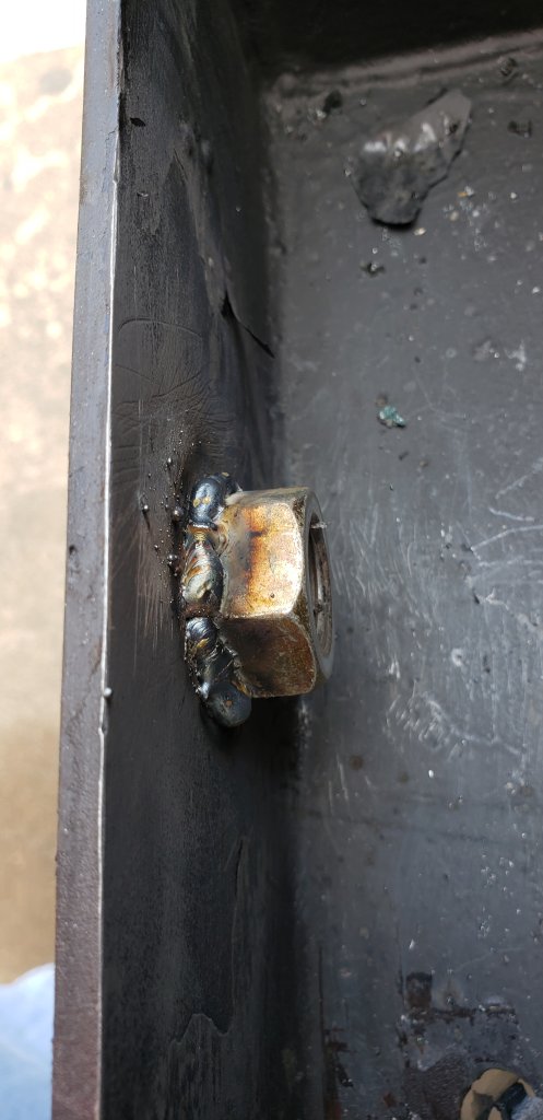

If you attempt this project, just do this with the nuts for the bumper shell bolts. Trust me. $20 bucks at a local welding shop will save you all kinds of grief trying to get a tool on those nuts with the bumper shell mounted. Did I mention that a smokingly hot MILFY chic in yoga pants did the welding for me...

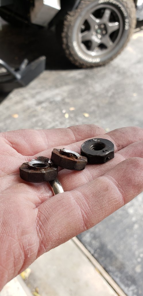

These are why Tactical Rovers "strongly recommends" you replace the factory hardware with grade 8 bits. These are what is holding your winch tray to your Rover if you don't replace them.
And in fairness to Tactical Rovers (which I am very happy with) I should note that if you have the later revision of their front bumper, then none of this should be necessary.

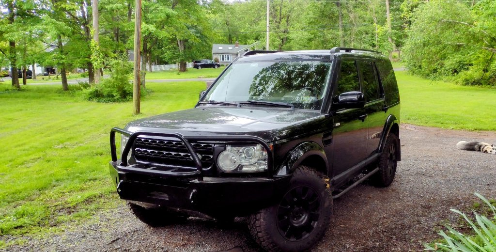

I've had my RTE bumper in my garage skinning my shins since November. https://rtefab.com
All you need is one weekend, or even one day.
Decided a few weeks ago ..enough was enough. Keep us posted
