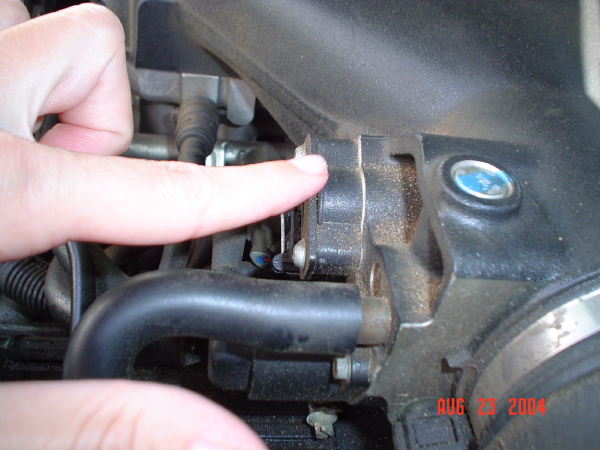

Here is a quick pic of my 1998 D1 (4.0 50D Engine). As Serg pointed out there is a world of difference: My finger points to where I believe my problem lies.

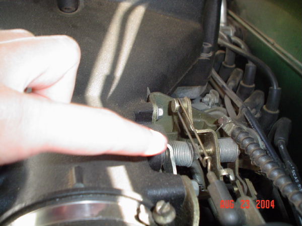

And here 1998 LR D1 versus Jason's 1995 3.9 D1:

Two things i still dont get - need to look in rave CD i sppse.
1) On second pic - why is that small hoose between your fingers aint got clamps on it, and why it points to rocker s cover? Is it connected right to it ? On 3.9L it goes to plactic T-piece that joins together flame catcher hoose and (not anymore for me!) crankcase breather filter on the left.
2) what you pointing at in first picture? And how is your stepper motor (IAC) btw?
3) no more pink nail polish? :)

(1) I believe (need to check workshop manual when I get home) that's a breather tube, Sergei.

Why the heck they put in straight tube there? It will suck in them oil vapors a lot.. On D1 there is at least crappy filter in between.
You most likely right Andy, it just kills me as weird tech solution.. :)
My 96 D1 has that tube as well -- and the more I think about it the more I think it is a breather tube of some sort. To equalize pressure between valves (where "bottom" end of tube hits engine) and combustion? I'm not sure, but I thought I saw that somewhere....
