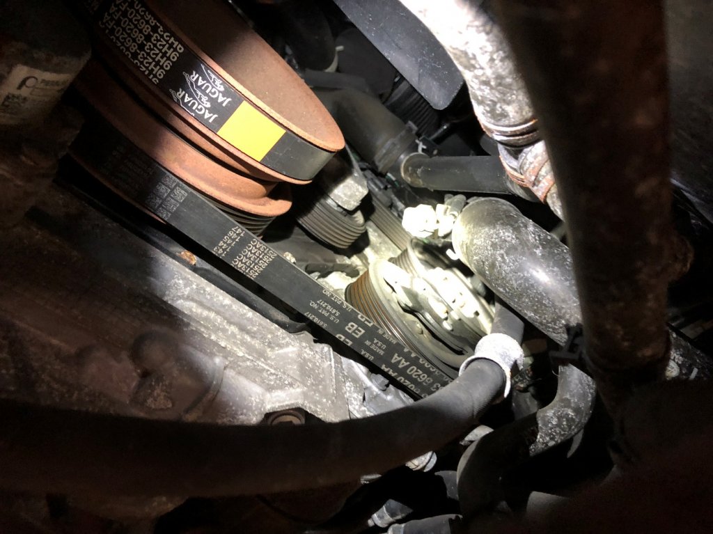

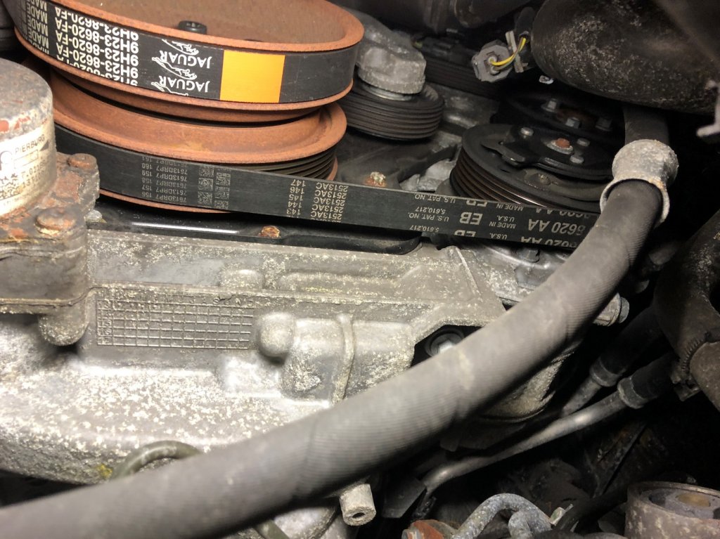

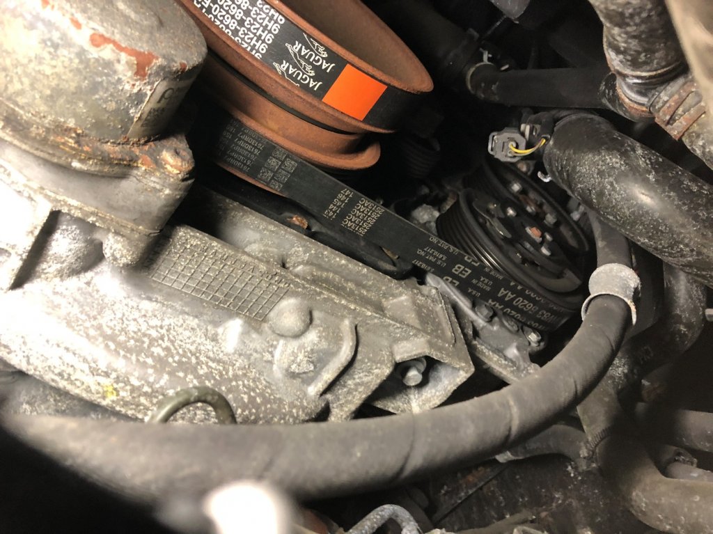

Well, I put it up on the lift, and the answer is that I found nothing. No trace of a leak.
I removed the two metal covers, did a bunch of cleaning (after all, I just drove 700 miles through salty northern New England and Canada) and I could not even get a clear view of the water pump. I took the best photos I could. The pan didn't have a single trace of a dried up drop of coolant. No dripping residue on any components near or below the water pump. Same story as the view from above.
I cleaned up what I could, hit surface rust spots with rust reformer, applied anti-seize to the screws and put everything back together.
At this point I'll just keep an eye on it and see when and if the coolant level drops.
