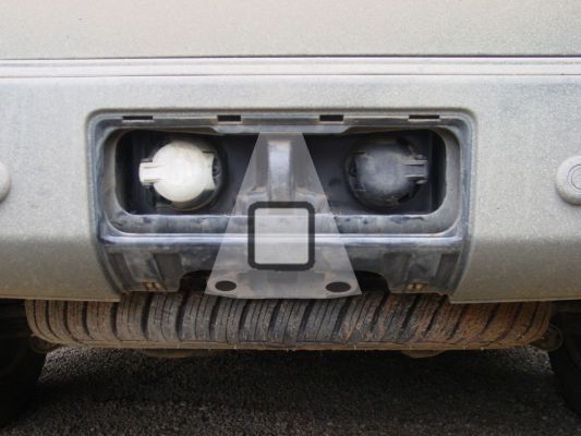

Holes are in sheet metal for power plugs.
If so, it actually seems like using the 2 holes in the LR3 chassis directly to the left and right of the rear recovery hook to loop the chain through, but that means the chain would rub on the plastic bumper cover, which I'm not too keen on!
The jpg below shows the two holes that I believe you are referring to, in use. The holes are for the trailer electric brakes and lighting receptacles. In the EU, the requirements sometimes result in you having two plugs, a 7 pin and a 5 pin in order to cover most of the EU trailer wiring needs.
In your case, just use the single metal loop that is in between the two holes.
