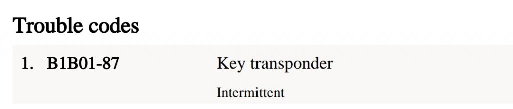

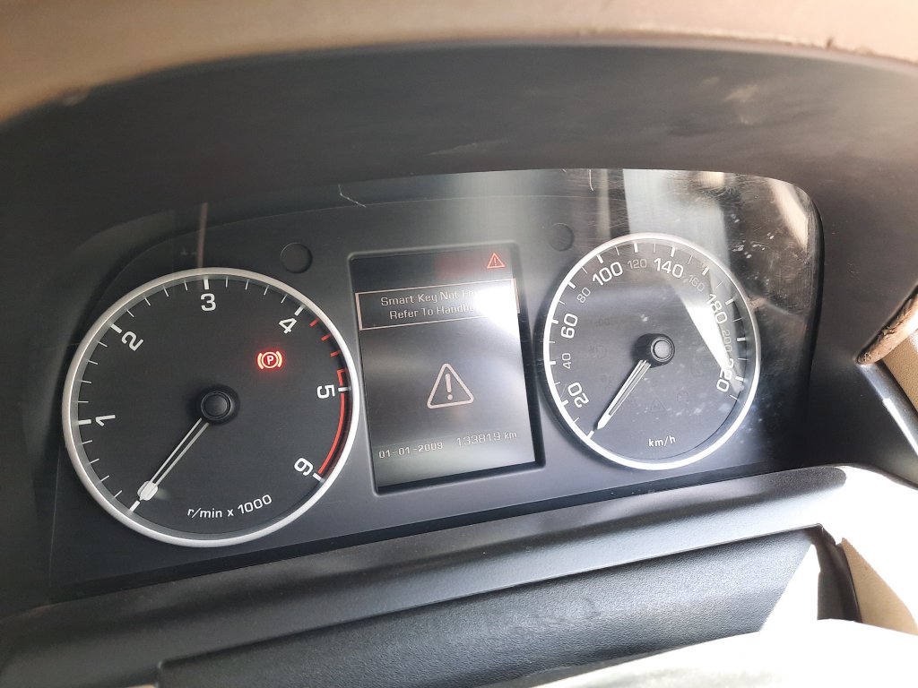

I have smart key not found message in display

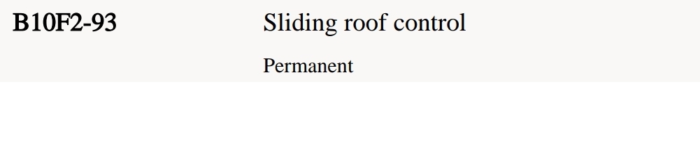

Also another problem for sunroof
How to solve the problem?
I attached the error code images
Please guide me
Thanks
remember5
Nov 26, 2014
415
133
If you only have 1 key I would guess it's battery is dead. There are other posts on forums where that code is related to the battery or trying to start the car with the key fob elsewhere. If you have two keys it's simple enough to try the other key. My LR3 has the battery soldered to the circuit board so to replace it requires skills at soldering. If your fob is not the original it may have a battery you can replace easily enough. If not I'm sure there is an electronics shop locally that would do it for you. First step is searching for "LR4 Key Fob battery replacement". And another FYI, your on the LR3 forum and that looks like an LR4 gauge cluster. Maybe I'm mistaken...
