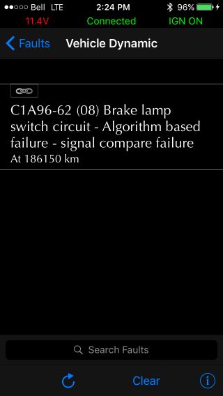

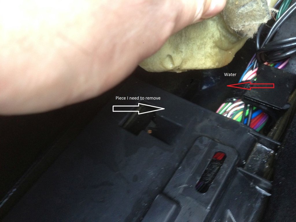

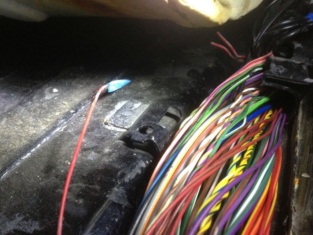

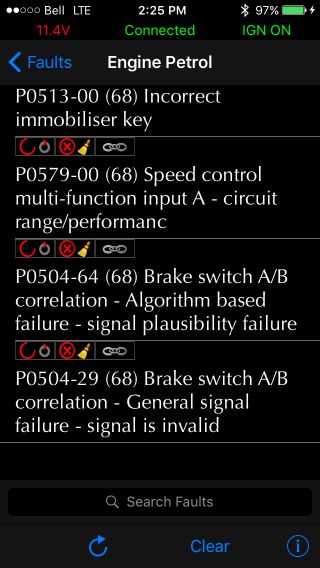

As others have mentioned above (note Ian mentioned drivers side, however on your's it will be passenger side), there is a factory splice that only got some crappy tape over it. That combined with water from leaking sunroof drains corrodes the joint and CAN lead to the problem. This gives good diagnostic info that you can check at the brake light switch:
https://www.disco3.co.uk/forum/transmission-fault-hdc-traction-control-off-etc-137607.html
Or just open up the sill and look for the broken splice:

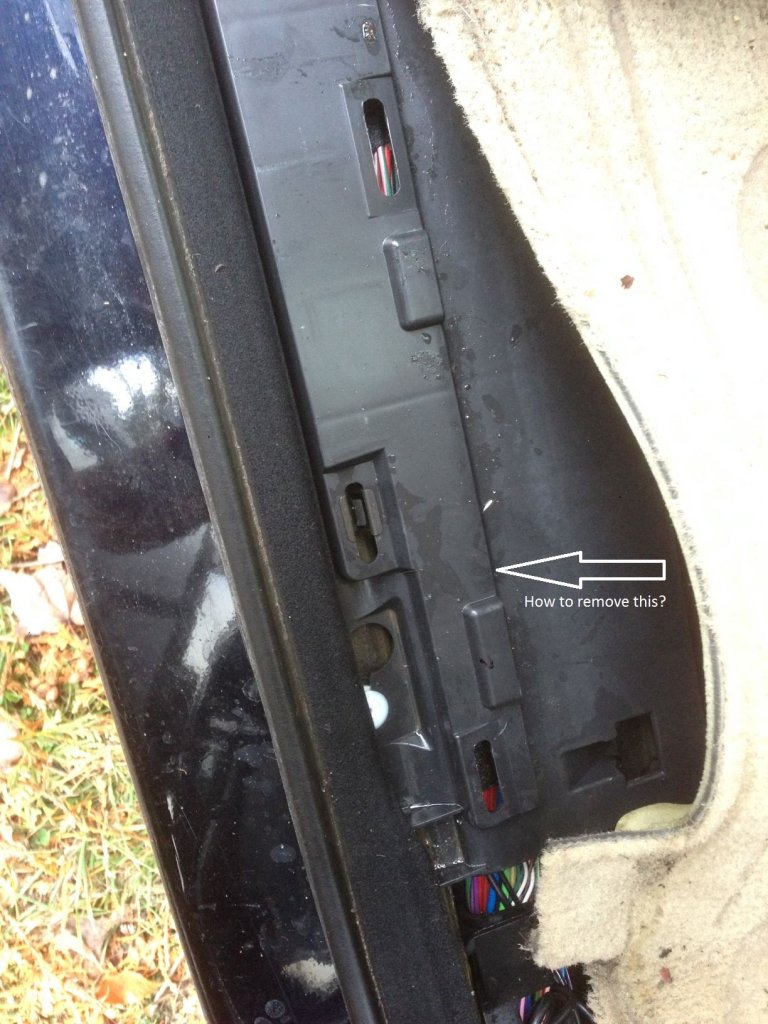

To get at it:
- remove B pillar lower trim
- remove sill cover trim (with Land Rover logo)
- remove trim where seat belt passes through seat base
- remove black trim around seat base. Front piece pops off, long side piece is held on by a Philips screw at rear, then there is a small torq's or security screw that holds the upper seat base trim at the rear, remove that, then with a lot of work you can wiggle out the lower trim piece.
- remove trim piece under dash, held on with two Philips screws, then the side kick panel (just pops off, uses same clips).
- now you can remove the large plastic piece that covers the wires. Use door panel tool to pop the clips.
Try not to break any of the clips... my dealer charged my over $8 each, I broke two on the side kick panel when reinstalling it.
Ignore the "how do I get this off" in the following pictures, just pop up the white clips using a regular door panel tool.
