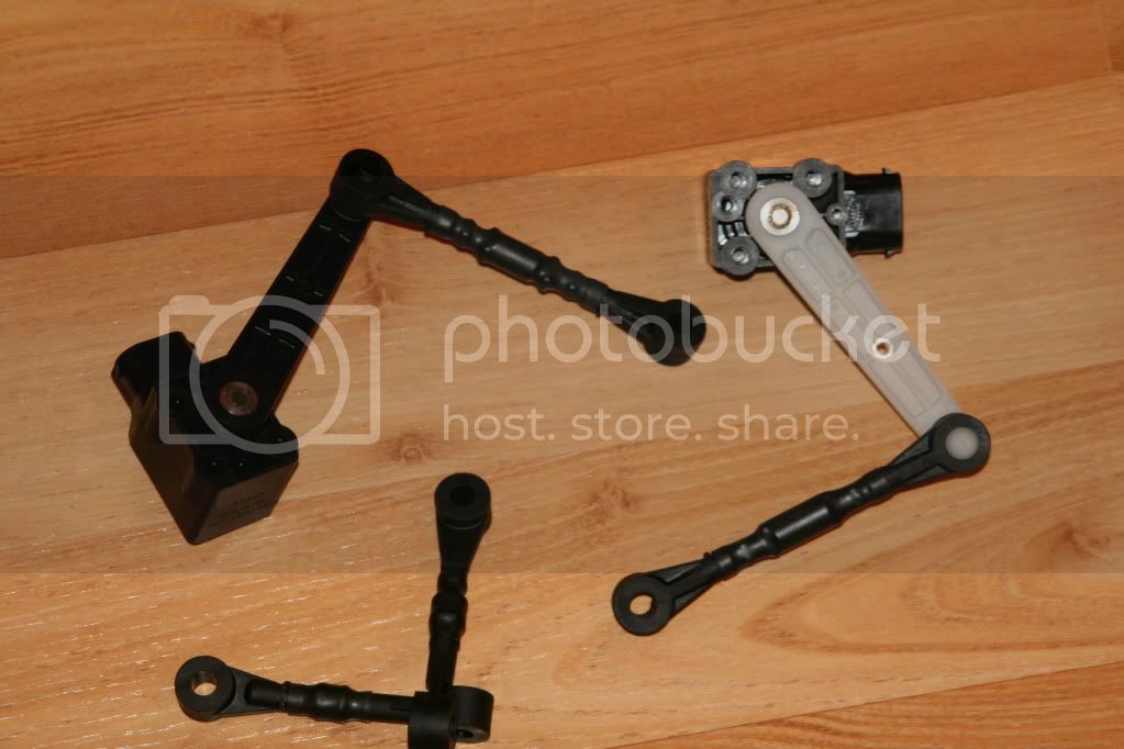

You got my interest :) What is a short rod mod? I bought the V8 HSE model with all bells and whistles. The car is a 2008 with 26,000 miles on the clock. She still has the original Goodyears which are in bad shape, however, funds dictate that I delay the replacement. I need an on road tire with sand capabilities, will not be doing any tough rock terrains over the short-medium term, choosing tires now has become tiresome :bootyshak

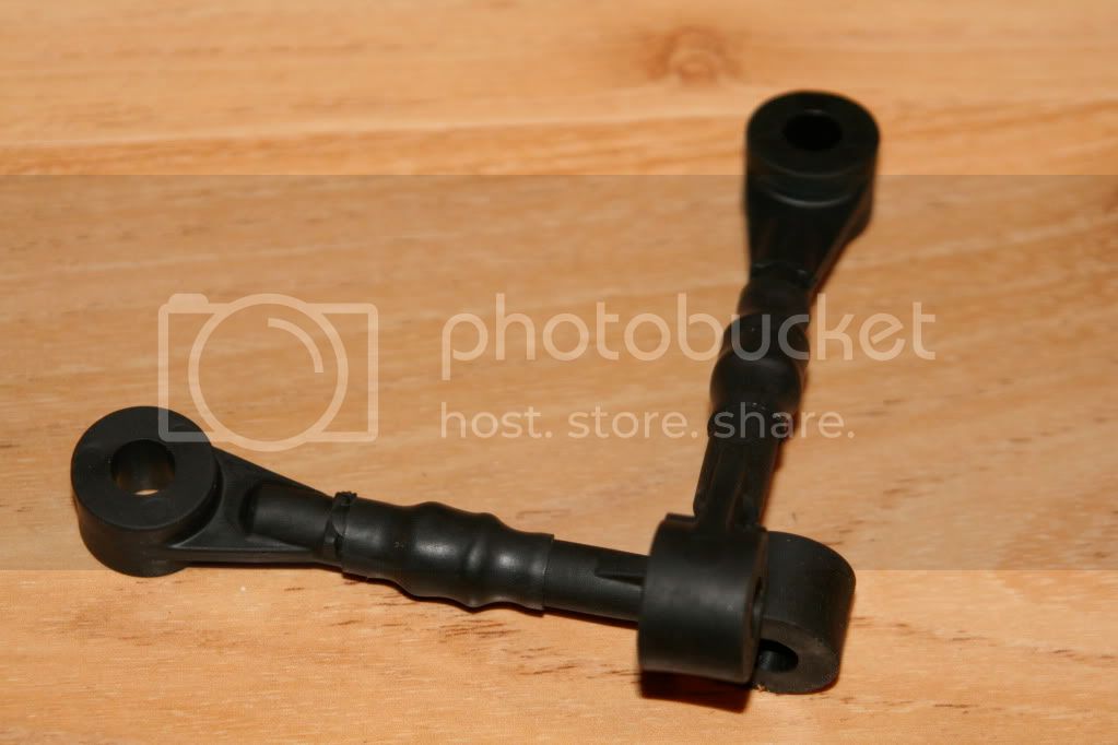

The rod mod is when you shorten the height sensor rods. look in my album. I make them all the time for guys. Yes dsc is the button is on the dash. It will stay off until you trun it back on or restart the vehicle. Off road height will go back to normal after you go over 30mph. The rod mod raisees you 2" in all modes so when you are in normal mode you have the clearance of stock off road mode. I have been runing it for a few years now. I run stock rods but when I am going to hit the trail I swap them out for the modified ones, it takes 15minutes they just pop off.
