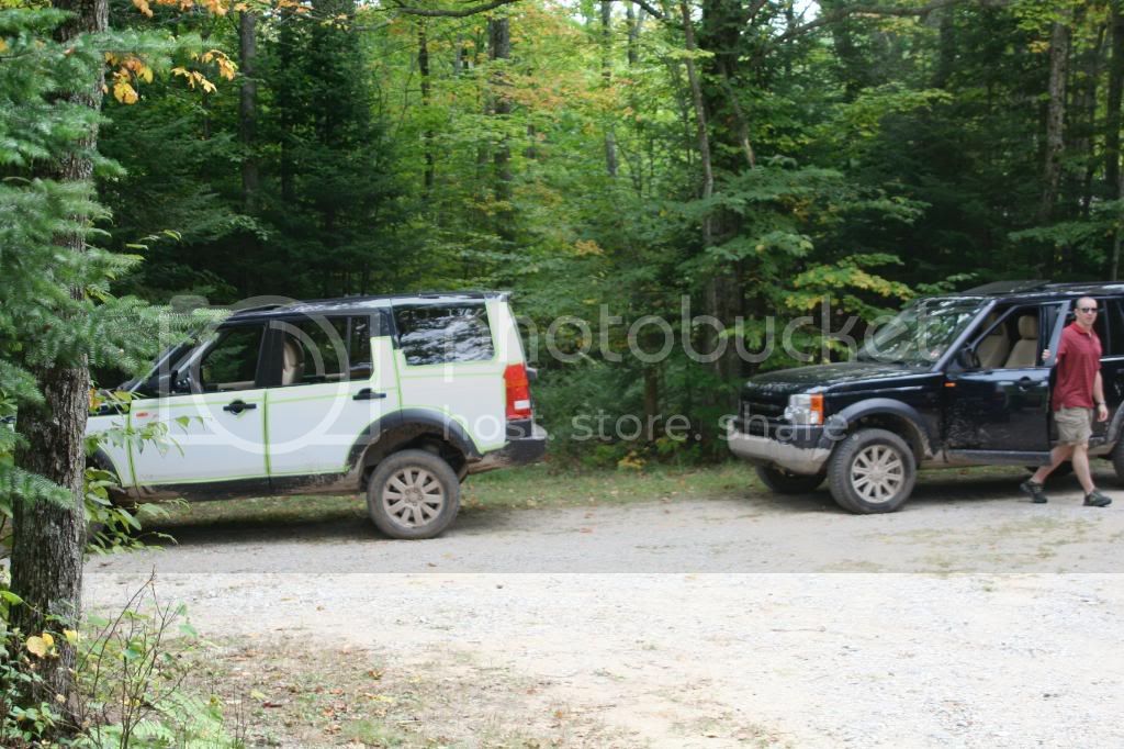

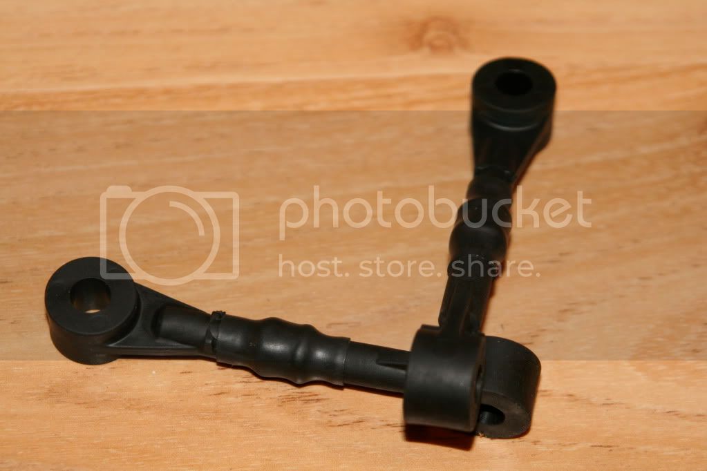

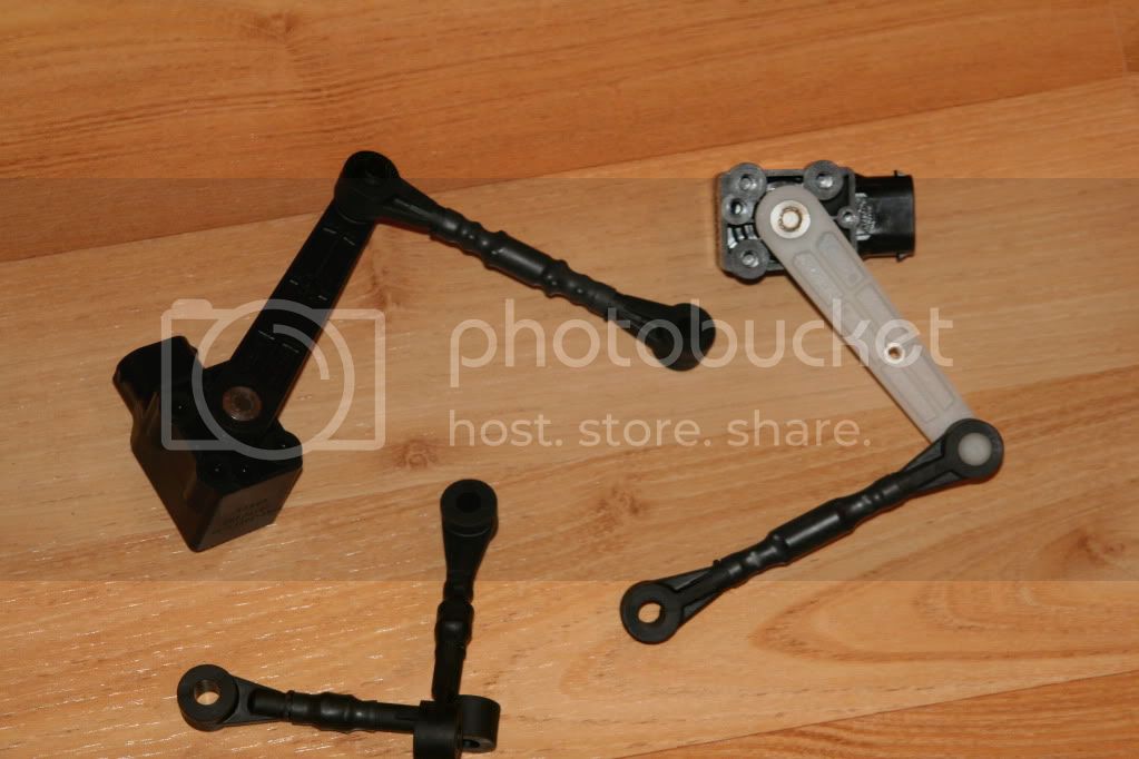

The rod mod is when you shorten the height sensor rods. look in my album. I make them all the time for guys. Yes dsc is the button is on the dash. It will stay off until you trun it back on or restart the vehicle. Off road height will go back to normal after you go over 30mph. The rod mod raisees you 2" in all modes so when you are in normal mode you have the clearance of stock off road mode. I have been runing it for a few years now. I run stock rods but when I am going to hit the trail I swap them out for the modified ones, it takes 15minutes they just pop off.
comparison in off road mode
