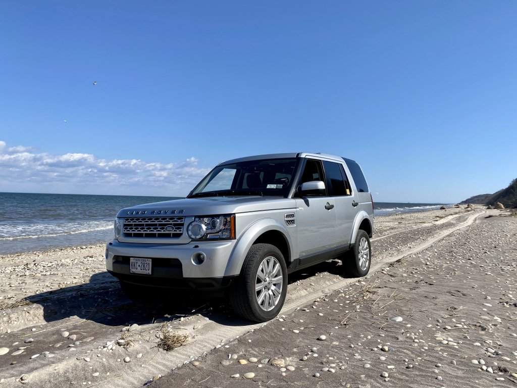

Where at? With stock size tires I’ve gone down to 18. Start around 25. Should go without saying you should drive extra easy that low on stock size tires and make sure you air up right after. Auto mode is fine, if you want to be fancy turn off traction control. I like to use low range to keep trans temps under control it it isn’t necessary.
Old pic attached, I’m on the beach at least once every other week.
