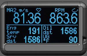

My 2006 doesn't have a reset oil monitor?? I use a ultraguage the number one best thing I've bought for my previous Disco 2 and now I use it in my LR3. It tells me the engine temp, oil monitor, rpms, etc... I got it for $50 from a member on one of these Landrover forums. I have it mounted on one of my air vents.
