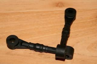

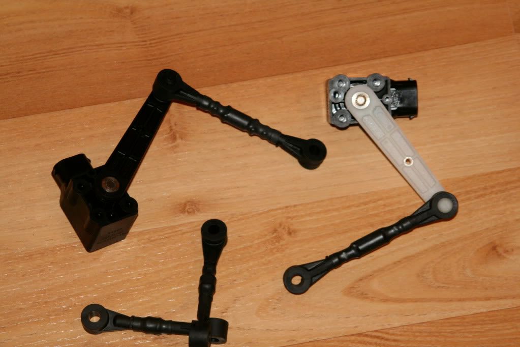

I have been looking at the pictures of the rods on your profile and I was just curious on what exactly you do to make new rods and what is the tape around them for. Sorry for all the questions, I just want to be sure before I buy they are durable and I wont mess up anything expensive.

http://i443.photobucket.com/albums/qq151/drzjoint/IMG_5378.jpg
http://i443.photobucket.com/albums/qq151/drzjoint/IMG_5379-1.jpg
These are the updated pics sorry about that.
No I use new rods so there is no down time.
They are stout and will hold up mine are no where near as enforced as the ones I make and are still going strong. There is veary little stress on the rods themselves. My profile now has the updated pics.
If you want less lift we can do that I can go to 5-8mm for you roverman. Thru testing by myself and others there seems to be no problems as long as you don't go more than 13mm that seems to be the max for reliability. I usually go 10mm so you ae still semi stock.
