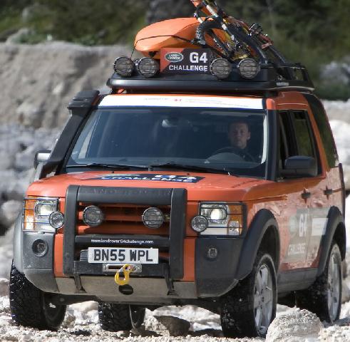

I am trying to install roof lights like those found on the G4 vehicles. I have been trying to find where Land Rover has these made and with no luck thus far. Based on the G4 page, I know that Hella is the light maker; however, they also had no information.
Any suggestions?
-Josh

The lights you are looking for and the Luminator Compact Metal Xenon. I do not believe they are available in the US. I called my supplier just to find out what they would cost to get here (just for kicks) Im not holding my breath. I would stick with a couple Rallye 3000's with some grills. You will save a bundle and stick get some premium lighting. You should be able to order them anywhere. They are singles and have no wiring included.

99% of all aftermarket lights are a single post mount. Any Roof Rack that you buy will either have tabs built in to the front of the rack, include them in the hardware, or have them available to buy as an accessory. The G4 rack looks like it has to be modified for lights, but im sure has the tabs underneath to mount them.

The roof lamps in both pictures above are Warn lights - 160's.
Only the latest G4 vehicles (MY 08s built for the now-cancelled '09 Challenge) have Hella 4000 Compact HIDs. The Hella 4000 (known as Luminators in EU) Compacts do not have grills.
The Expedition Rack (referred to as expo rack on other sites) does NOT have lamp brackets behind the fairing. Lamp brackets need to be fab'ed. These are what brackets look like from an actual G4 vehicle:
