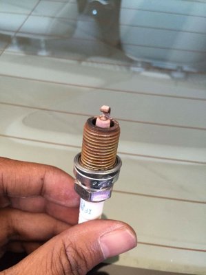

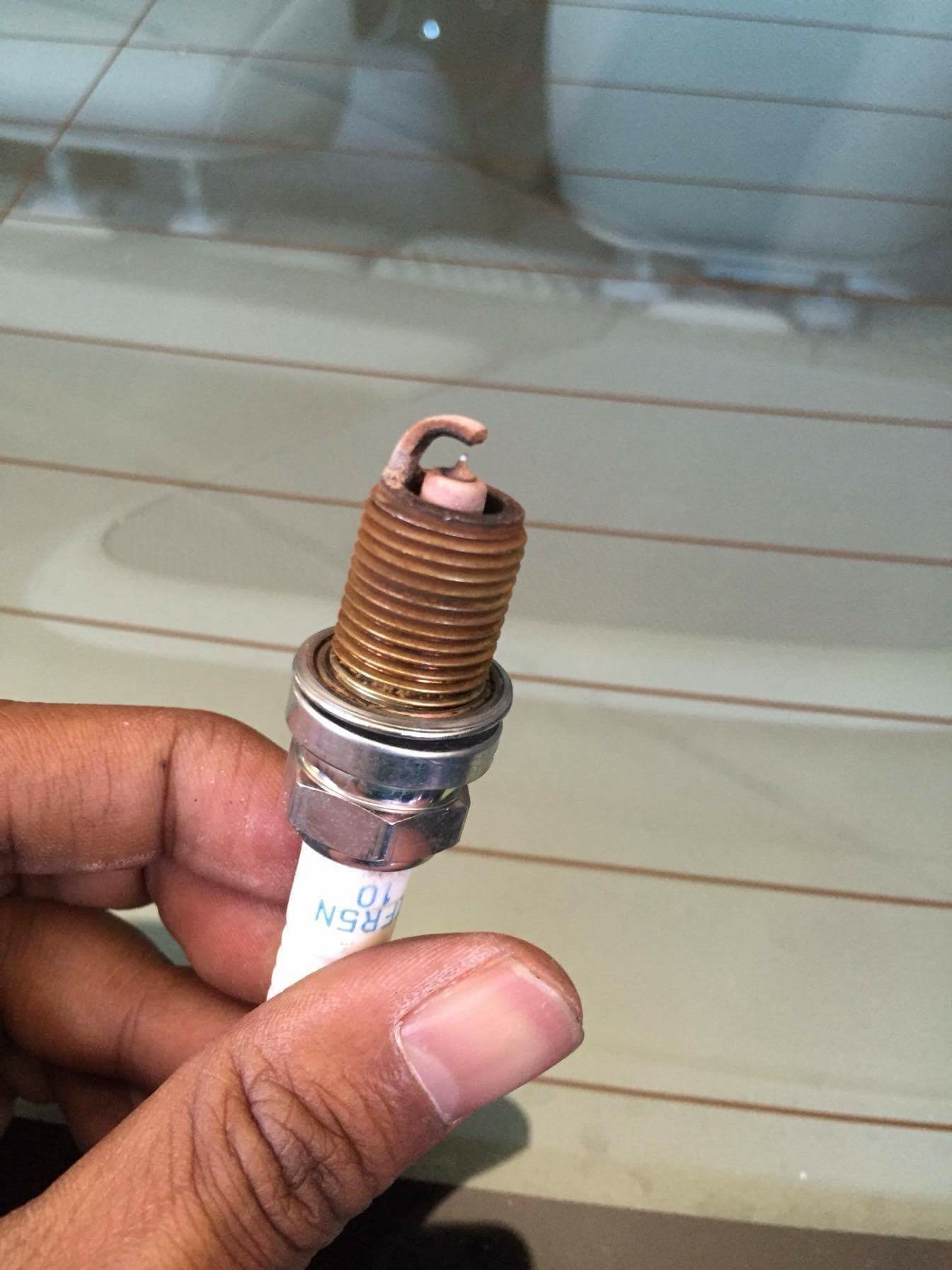

This is what the spark plugs look like. you guys think they need changing?
Houm_WA
Jan 6, 2006
3,948
261
Ewwww....yeah I mean, change 'em. You've already gotten to them.
