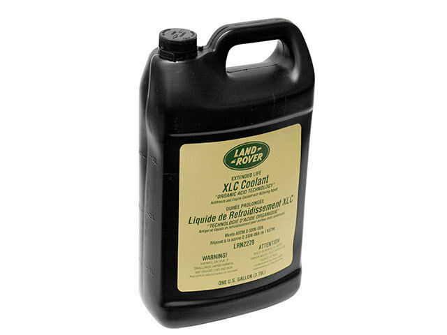

However, the Land Rover antifreeze is supposed to be a similar formula - but I don't know if it's identical. Or if the newer versions of DexCool are "fixed" to eliminate the problems with the original stuff. Either way, the OE/dealer Land Rover stuff would be the safe route. Part number LRN2279, ~$25 from aftermarket vendors if you don't have a local dealer. I think my dealer charged about the same for 1 gallon.
https://www.fcpeuro.com/products/land-rover-engine-coolant-antifreeze-genuine-rover-rov-lrn2279
