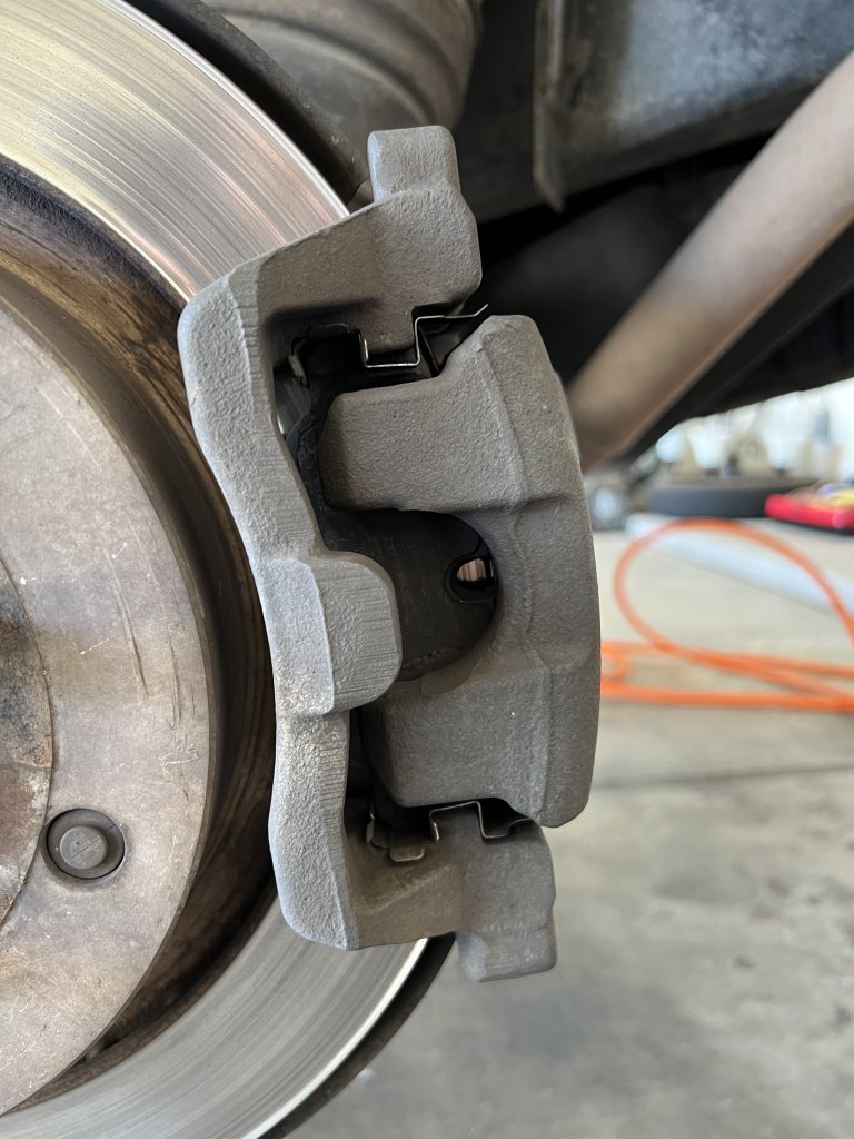

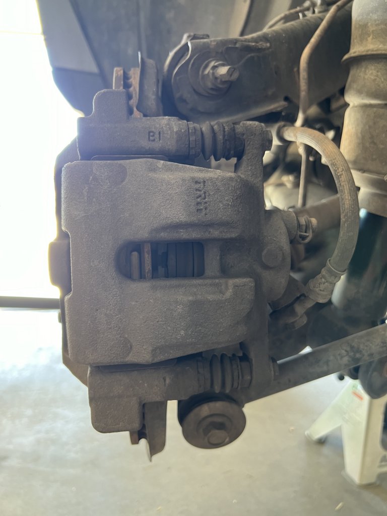

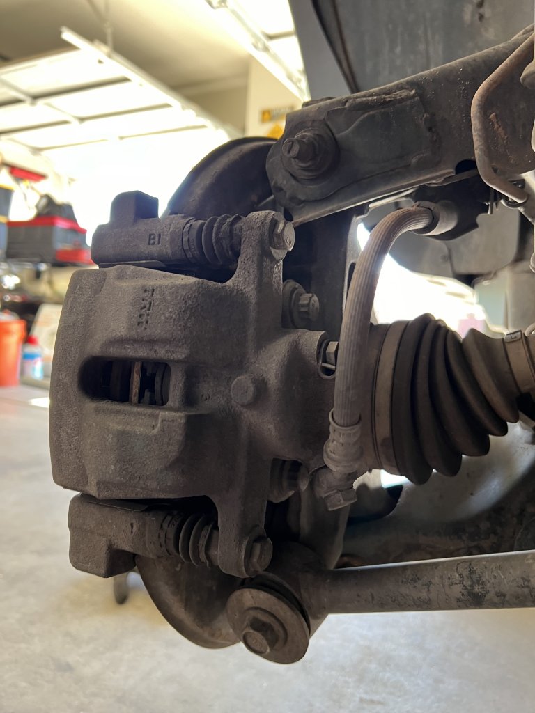

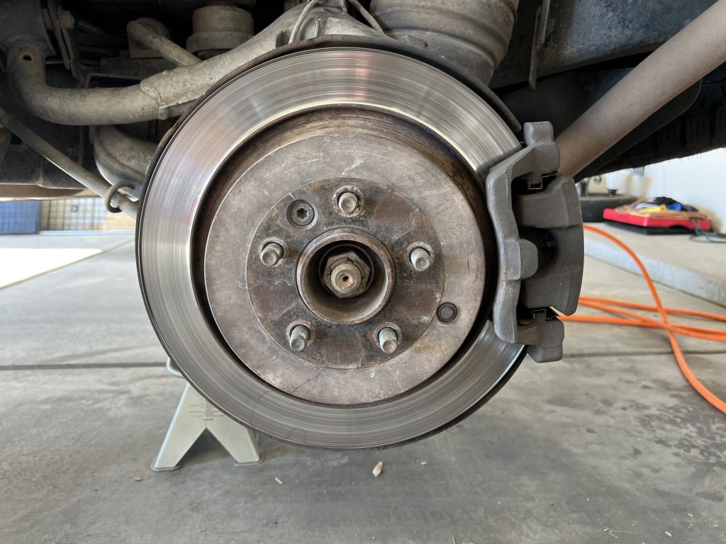

Here’s some photos of my 2013 calipers. Not sure if there are any notable differences between these and the older ones, but I did realize that my brake pad clips don’t appear to fit correctly.
Don’t mind the rotors. New ones are on the way. I’m sure these are way out of spec at this point.
1,874
Without looking at mine right now, those 2013 brakes appear to be the same.
I just looked online, though. The 2012s and 2013s have the same caliper part numbers, but different carrier part numbers.
2012 is LR015521 (R) and LR015522 (L).
2013 is LR032058 (R) and LR032059 (L).
The plot thickens.
