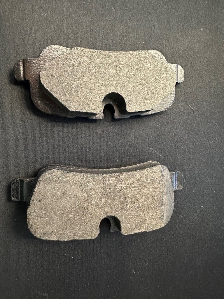

What's with the part number change on rear brake pads between the 2012 and 2013 LR4 model years?
The 2012 model year is LR139969, which look like these: https://www.fcpeuro.com/products/land-rover-brake-pad-set-ferodo-lr015519
The 2013 model year is LR134696, which look like these: https://www.fcpeuro.com/products/rover-brake-pad-set-ferodo-lr134696
They 2013 ones are bit more expensive, but have significantly more brake pad material than the LR129969s. One of the edges is beveled on the 2013s, too. The 2012s have an adhesive backing for the outermost pads, whereas the 2013s do not.
Below picture: 2012 on top; 2013 on bottom.
I accidentally ordered both from FCPEuro (I mistakenly thought the 2013 version was the front brake pads -- switching out my Hawk pads because for some reason I can't get them to stop squeelling after around 3,000 miles).
My caveman brain tells me more pad material means "better," and to run the 2013 pads on my 2012 LR4. But just curious if there is something I am missing. Guess I've been running aftermarket pads during the entire 8 years I've owned my LR4 so I have never encountered this before.

When I had pad separation of the rear pads, I bought new pads from the dealer for my 2012 and they gave me pads that look more like the ones you posted for 2013+. They fit fine (and I think had a chamfer on both ends). Not sure which part number I got, will see if I can find out.

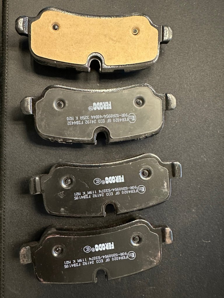

Like I said above, the 2012 pads for the rear have one with an adhesive backing and the other with a plastic backing. The 2013s have no adhesive backing and are all plastic-backed.
1,874
Here's a pic of the back of the pads. Top two are the 2012s; bottom two are the 2013s. The tan part on the top 2012 is a film you remove once the pad is installed to reveal the adhesive backing before you install the caliper.

The Atlantic British how-to video on the rear discs/pads talks about the adhesive pad thing here:

There is a VIN split on the 2010s for the fronts too. I never fully determined the difference although I think the original had too much pad material and they dialed it back a mm or so.
1,874
Interesting.
I should add that there is no difference in the pad thickness between the 2012 and the 2013 brake pads. It's just a difference in the surface area, and the 2013s have that one beveled edge.
