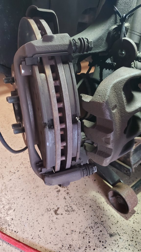

Just closing out my experience on this topic. Replaced Rotors and pads and greased caliper pins. Bought the Zimmerman rotors with the Akebono ceramic pads. Completely solved the shimmy issue. They had gotten progressively more warped by the day, to the point where the shimmy was constant even without the brakes applied. No idea what caused it/them to warp. They were JLR pads, not sure about the rotors as there were no markings on them. Only thing that seemed odd, was that the passenger side rotor was stuck to the hub pretty good. Hate that I had to replace brakes so prematurely, but at least she is back to her smooth riding self. Here is a picture of how much pad was left on those brakes... very unfortunate.
Have battled runout on these before, they can be temperamental. What 99% of people don't do is measure the disc runout once the rotor is installed to check that it is within limits. This ensures the rotor is mated to the hub nice and flat. Pay attention to the hubs and mating surfaces when replacing rotors.
