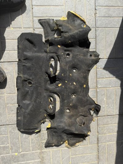

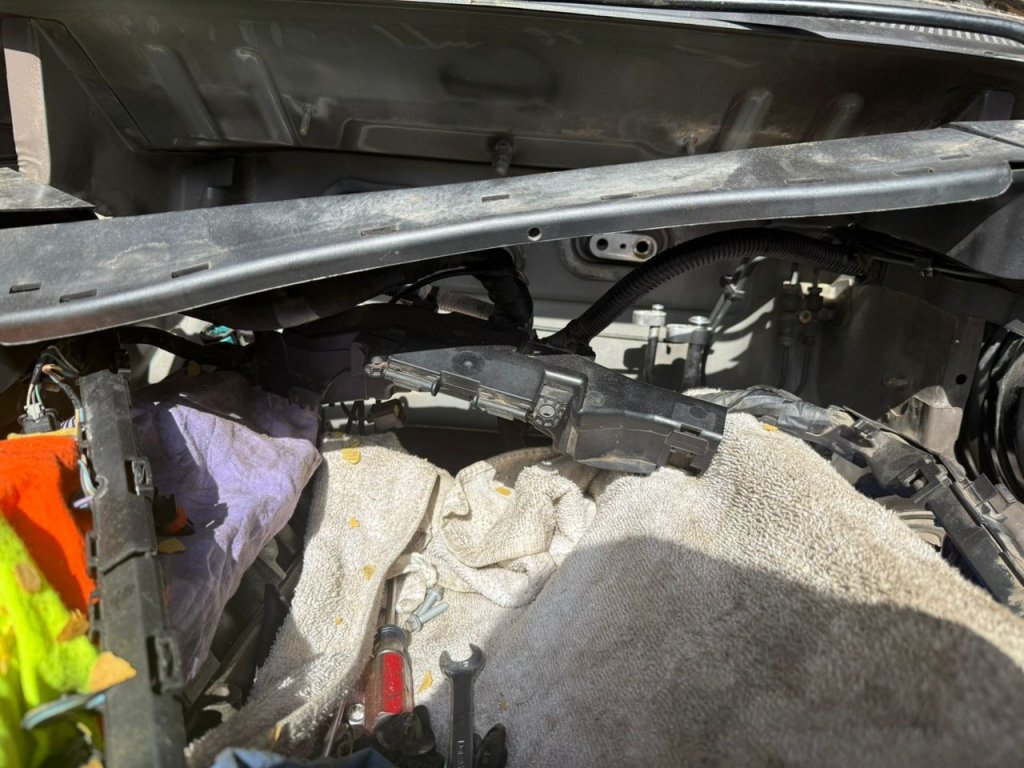

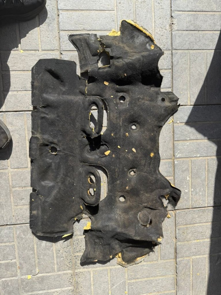

Here is the bay looking at the bulkhead with the insulator removed as well as the actual insulation.

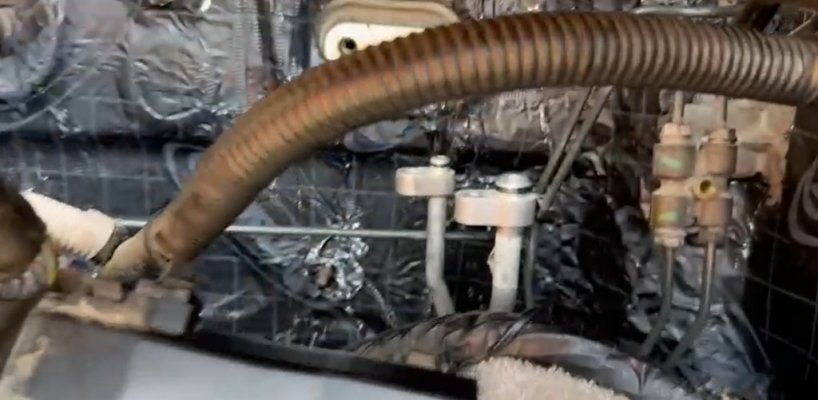

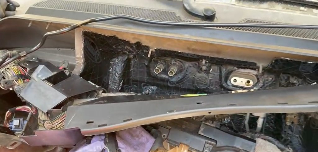

This is the "new and improved" dynamat extreme sound deaden-er and heat insulator matting installed on the bulkhead today.

Thanks @powershift and looks like we will find out if this is any better....
The plan right now is to do more in the engine bay, including using dynamat, on the underside of the hood.
I can post photos separately and if really helpful, maybe making a new thread for heat and sound proofing the hood (perhaps there is interest in such things?)

Main problem with the factory insulation is mice like to use it for a nest. I don't think they're particularly interested in eating dynamat.
And I forgot to mention - you seem to be right!
While I have not had any furry friends in my LR4, the latest edition of LR Time, with Christian and Vera getting
"the Cheapest Land Rover Discovery 3 in Germany"​
there are several mice nests in the LR3 they acquired as their newest project vehicle...and it indeed looks like these mice have used this very factory insulation in question. Hopefully, as you allude, these animals won't think much of the dynamat (and that it does a better job than the factory stuff, which I have never thought much of)!
