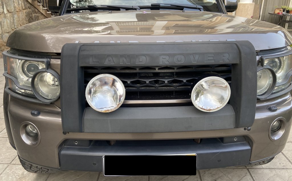

This is what the OEM (Hella) Lights installed on my LR4 look like (with the "older" bumper / grill / lights and the plastic brush guard thing).
If folks were wondering about the brush guard, I can tell you all about it...but since it's no longer available I figure folks are not very interested.

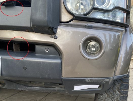

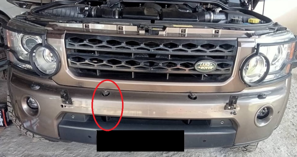

Here is a close-up of the upright steel bracket which you can see behind the plastic (old-style) bumper assembly - circled in red.

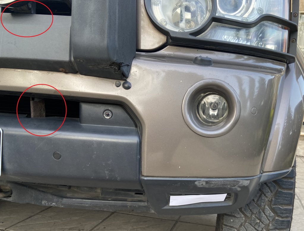

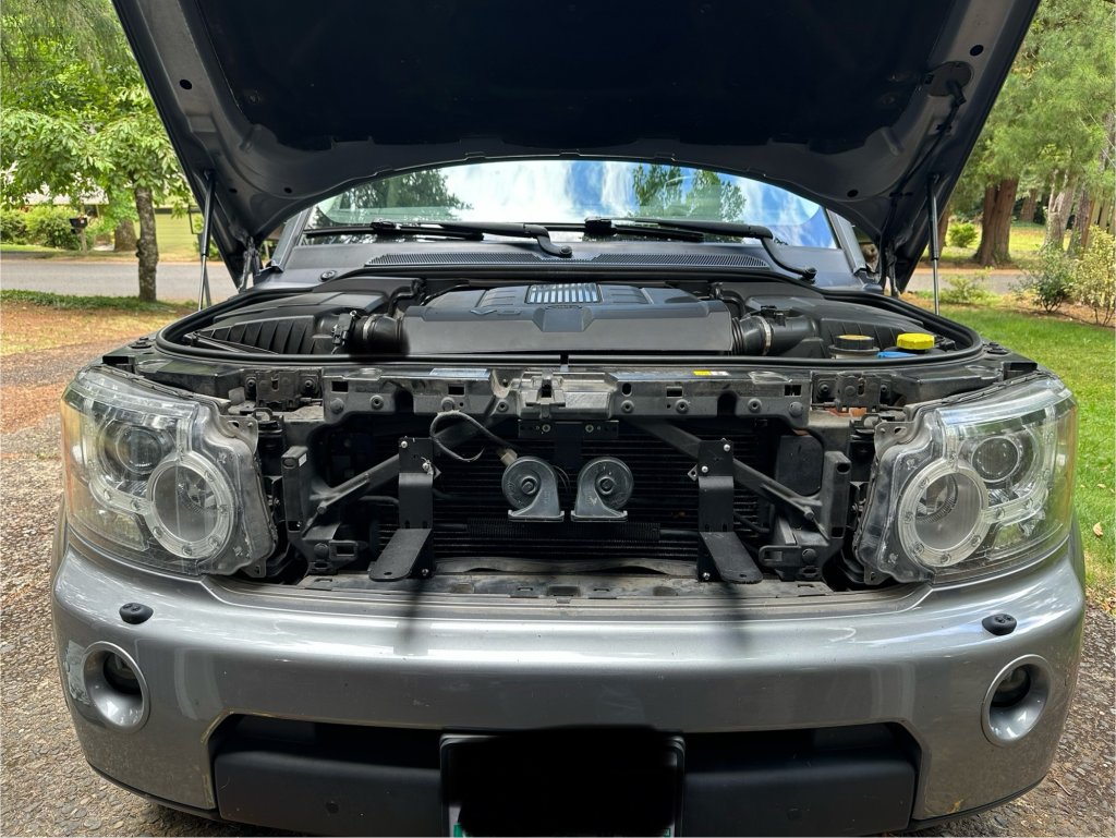

Update on my upgrades and project - attached are two photos of the front grill area with the OEM accessory light mounts (without the OEM light brackets and lights or the plastic "Protection Bar").
The Red circle illustrates the steel upright (now cleaned and painted).
Plan right now is to install new accessory lights from Baja Designs and we are still working through wiring harnesses and whatnot such as how to best mount the new accessory lights.

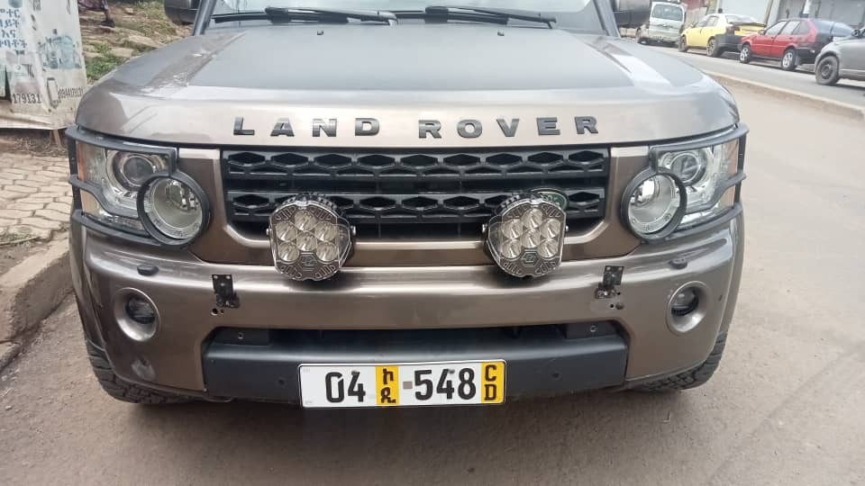

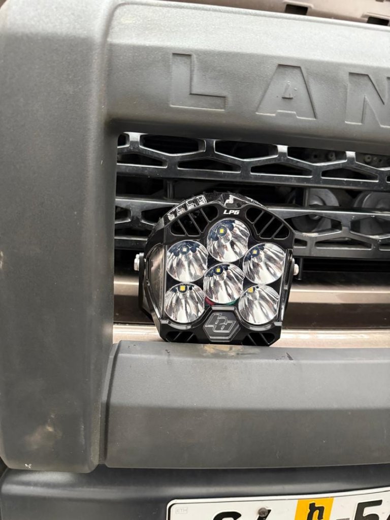

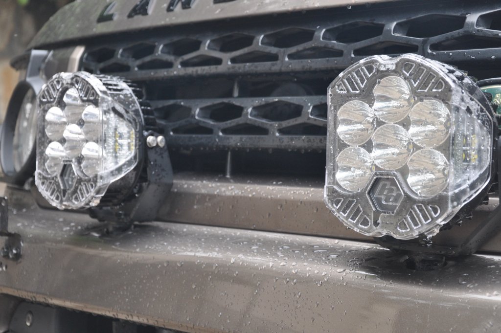

Update Part II: we have done the first installation for the new Baja Designs lights (LP6; the LP9 seemed too big and bulky for the mounting in front of the grill...they were almost as big as the grill!)
Here are a couple quick photos of what they look like. More testing and design necessary but I am certainly interested in what folks think...Any additional insights most welcome (perhaps there are a few who have tried the Baja Designs out there?)

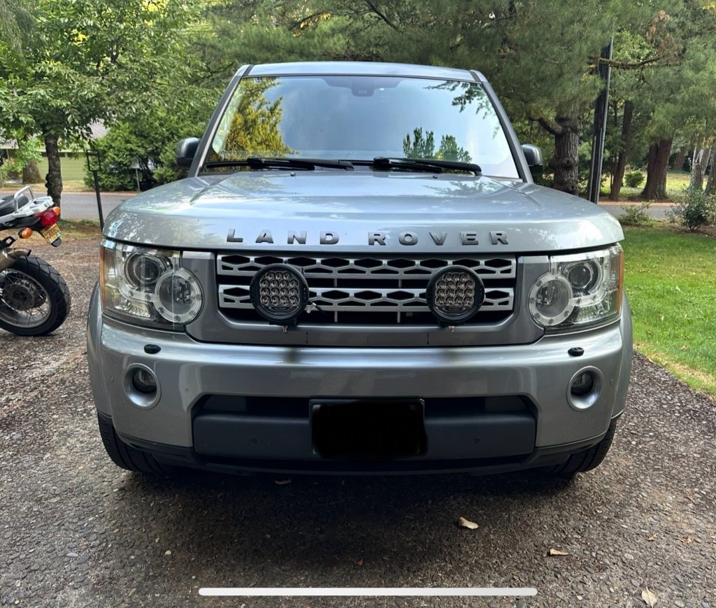

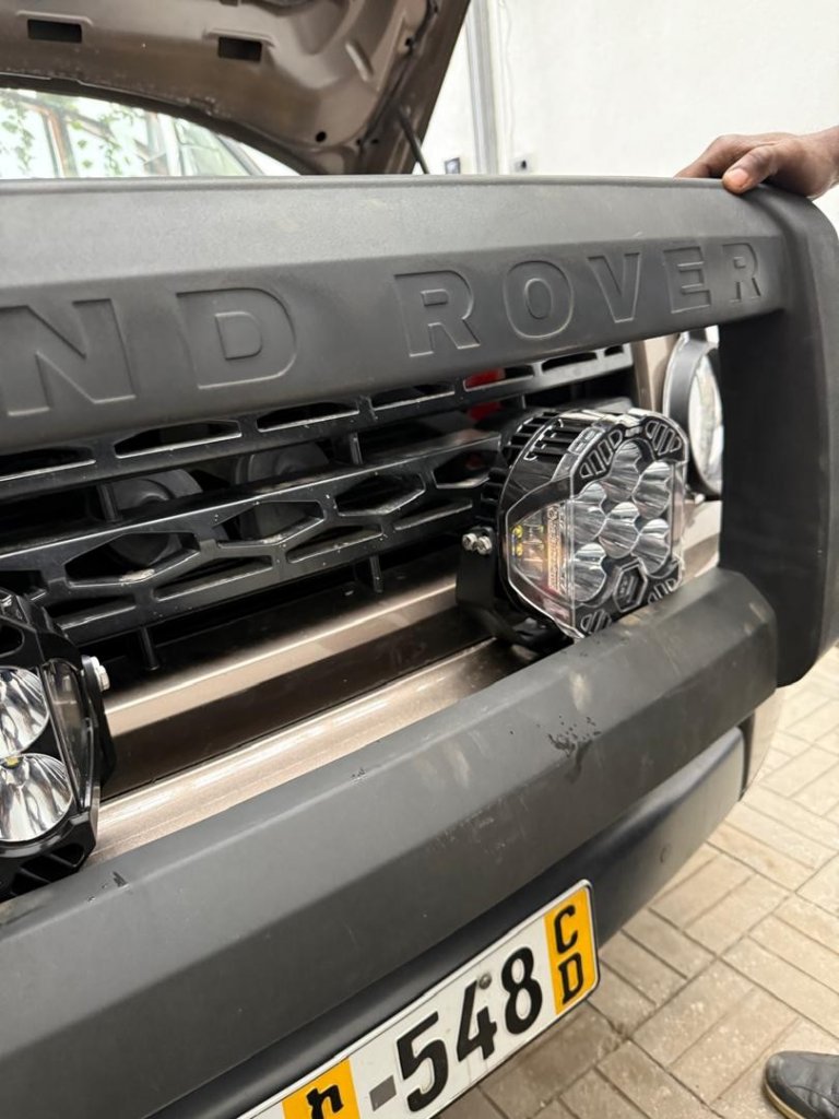

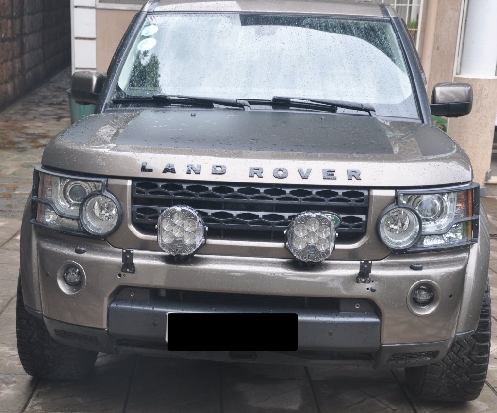

Update -
Where we stand mid-July with the light upgrade, and perhaps it would be worth opening a new thread on Baja Designs?
I am not happy with the present layout but am very happy with the way they look and sit on the truck. The issue here is that they are too low for the "Protection Bar" so I am looking at getting some aluminum blocks machined so we have about an inch rise - which should fit just right inside the protection bar (and maybe even look better as they will be on the center of the grill then.
Still working on the wiring harness....
More to follow and certainly welcome anyone's expertise!

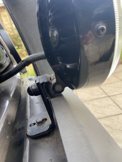

Brackets installed. Lights mounted and wired. Function test scheduled for tonight
Two observations/questions:
1. Brackets are clamped to the radiator protector/cross members- there's lot of vibration. Inducing movement in one lamp causes the other to move as well. May end up needing additional stabilization....bouncy lights are the suck.
