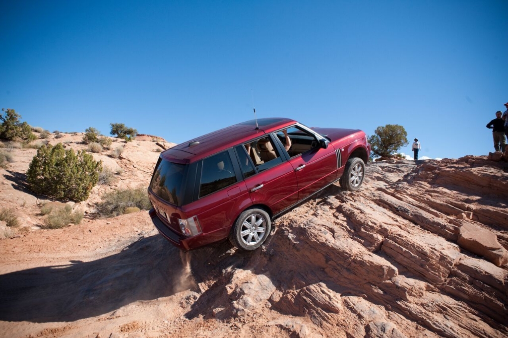

The 265-65-18 (31.5") is right at the point where you should consider having the lift.
That size has been a popular choice and generally its done with the lift because it looks and functions better with the additional space.
Here is an example on a full size Range Rover with a Johnson Rod lift taking advantage of that additional space. So if you take your LR3/4 off road like this then you should consider it.

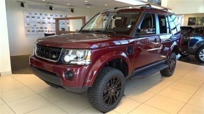

In my opinion going over 32 inches only invites more problems.
I always recommend not exceeding 32 inches.
The Johnson Rod lift has been the most reliable lift for the last six years. When Land Rover dealers lift their vehicles for sale they don't use an IID tool. They use the Johnson Rod lift. It just works like the original part and that's what they care about.
Here is a Land Rover Dealer using a Johnson Rod lift with larger tires to increase sales in their showroom.
