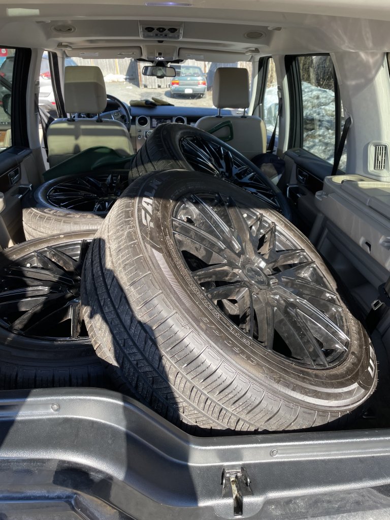

Hello - Looking for some help to get a new set of wheels to fit a 2019 LR4 HSE.
I just purchased a set of Niche 164M Anzio wheels https://www.nicheroadwheels.com/wheel/7326/niche-sport-series-anzio-m164/?finishID=2345&lugs=5
These are the 20"x9", 5x120mm bolt pattern, 35mm offset. A few additional details via the link.
My auto shop says the LR4 bolts are to short. Do these simply need wheel spacers to fit (possibly hitting the calipers)? If yes, how would I determine the size of the spacer (eg, 1 in vs 1.25 in). Other threads have suggested BORA Spacers, but need to confirm this will solve the issue first.
The LR4 stock lugnuts also don't fit the new wheels but hoping to solve this with the wheel manufacturer.
Glady take any suggestions. Cheers.
