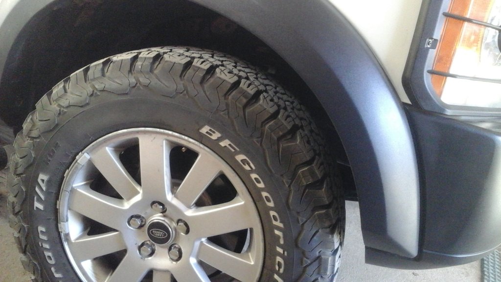

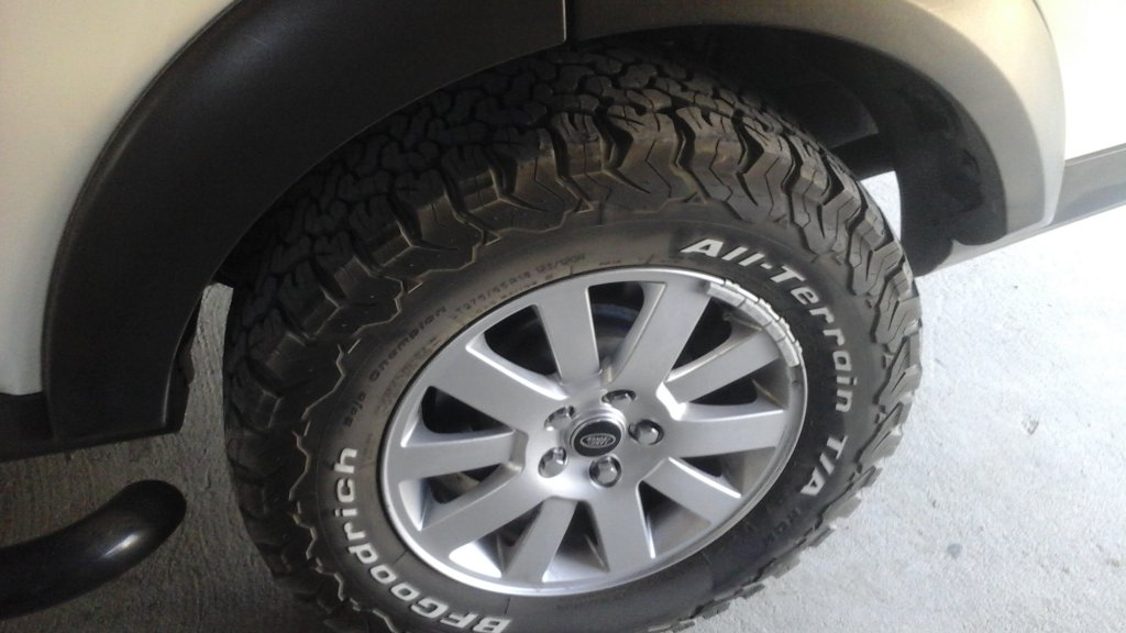

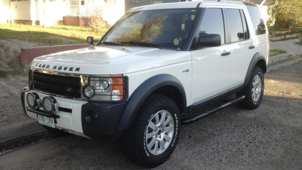

I see from the pictures you're not running rock sliders - in fact, it looks like you have running boards (!). That tells me you are not looking to do much more than fire roads. That's fine - it's what these trucks are best at. With that in mind, I really don't think you'll be happy with a full MT tire. It's going to be louder, more expensive, and get worse gas mileage. Again, I would recommend staying with something in the AT world.
Drome
Feb 9, 2017
27
Colorado
I've been delayed by a medical emergency with my wife. It may be a few weeks now. But it will give me a chance to post some pics of the clearances I have currently. I get them done tonight after I get back from Denver.
