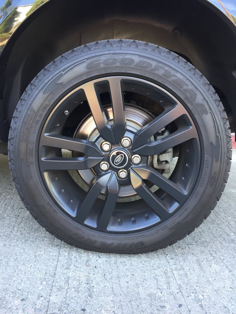

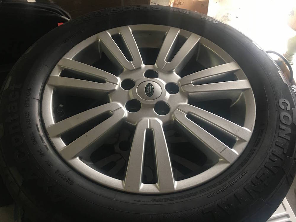

My truck has black 20's that I want to keep in their current good condition so I've been planning out a second set up for off-roading. My underlying goal, max out tire size without altering the car (much at least). The Comp 18's were more than I wanted to spend so I've picked up a set of stock 19's for off-road tires. It seems like the two best options for the 19's are the Cooper Zeon LTZ's and the Duratracs according to what everyone says here.

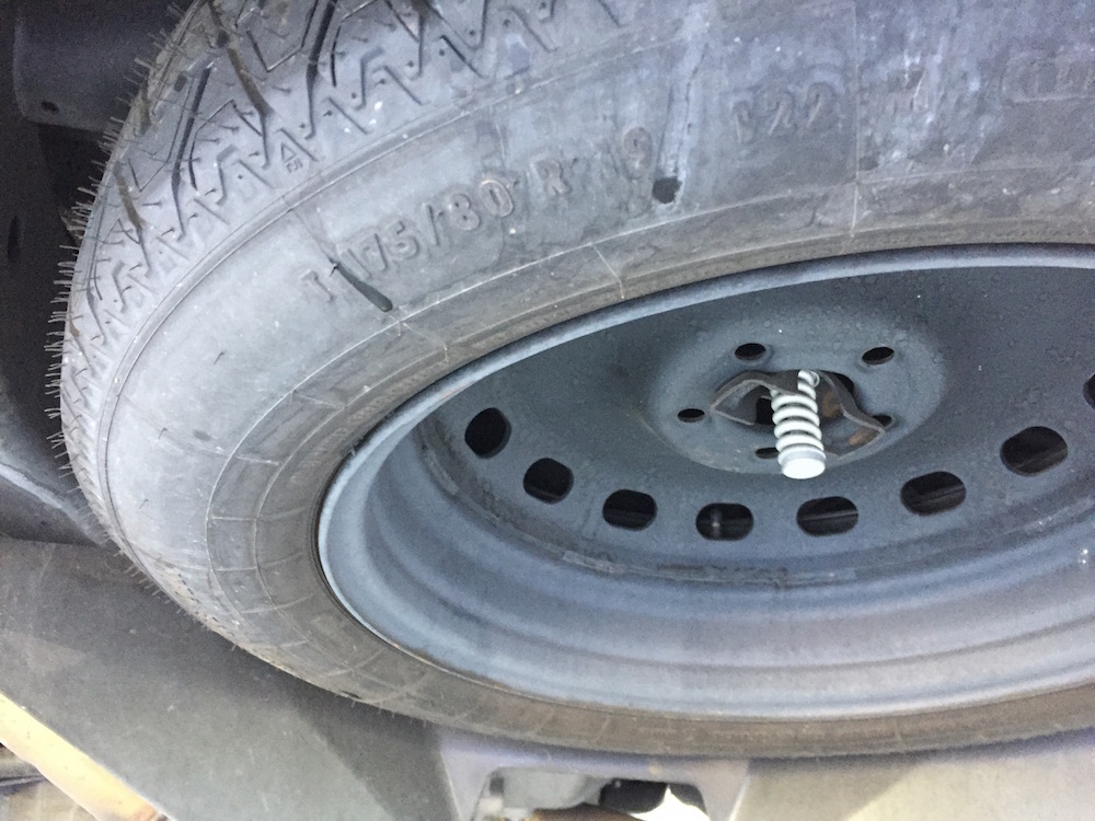

- Can we fit that largest size tire I'm looking to put on the 19's as a spare under the car? If not, how large can we get under there?

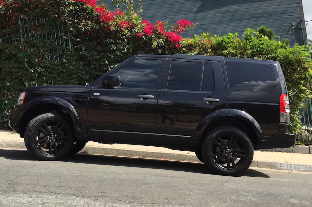

Many thanks in advance for any insight. I know we all like to see pics, though i'm not sure how much they really mean in this instance. Anyway, here is the truck, my current wheel, the 19's I picked up, and my current spare.
