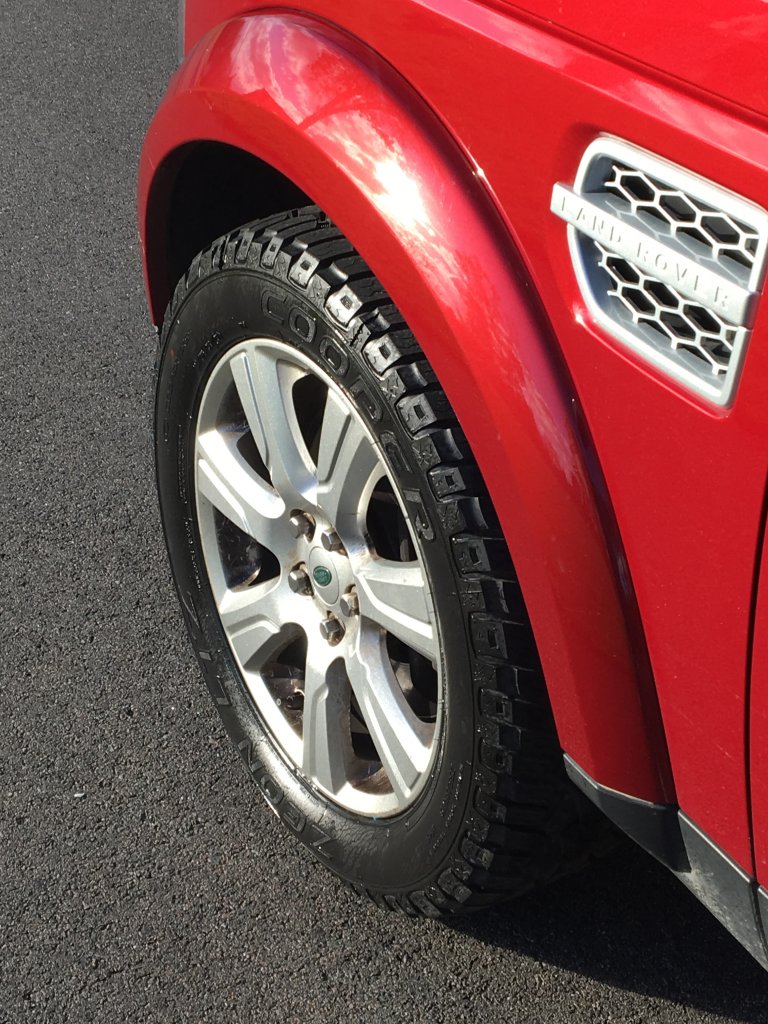

I went to a local off-road tire dealer and he steered me away from Duratrak as the rubber was a little harder and when it does wear (in his experience with his Jeep) the tires get very noisy. I just bought the Cooper LTZ in 255 55 R19 and I love them so far. I wish BFG made an AT for 19s :-(

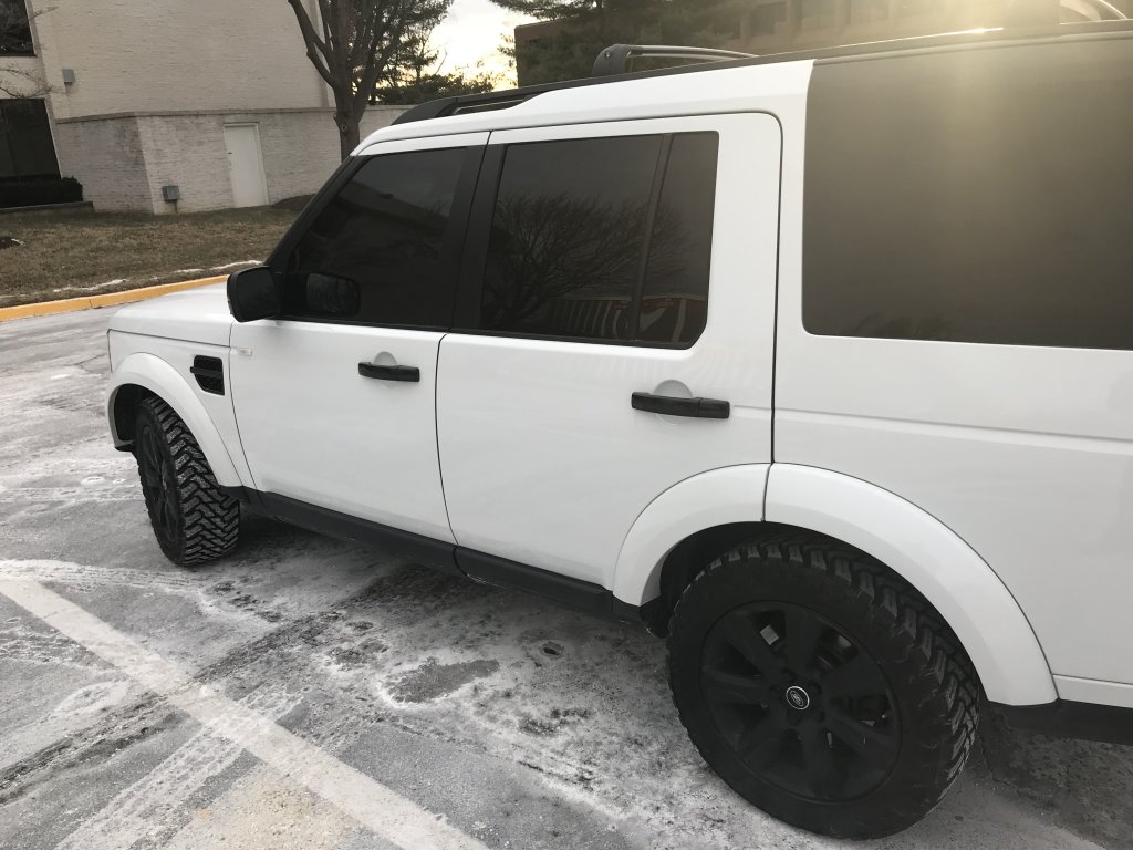

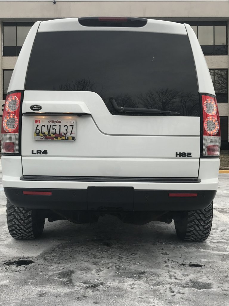

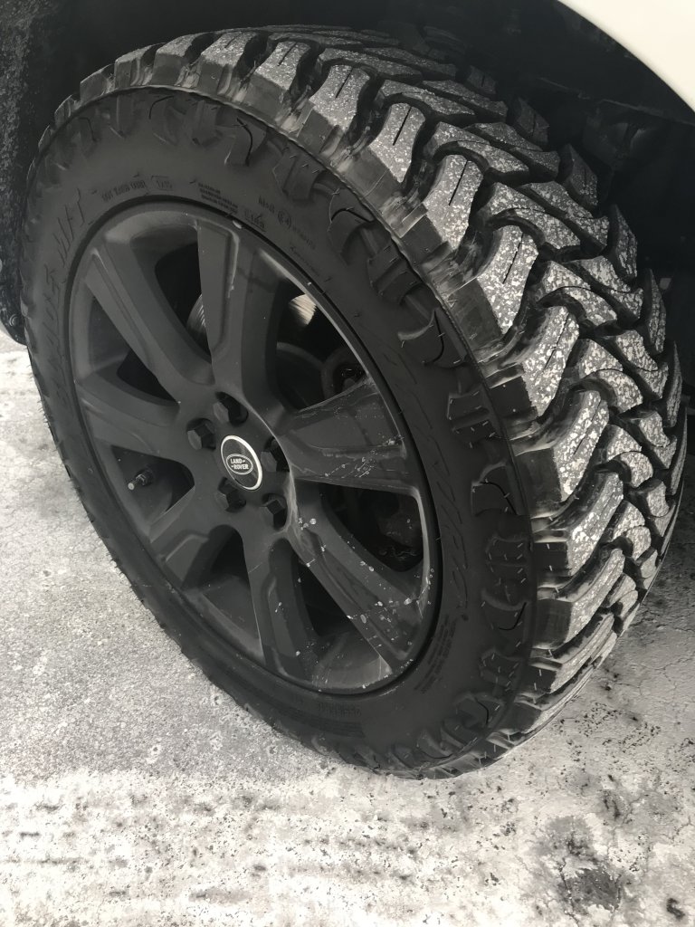

I purchased the Atturo Trail Blade M/T. The drive very well but they are extremely loud. I love the look and performance in the mud so I can overlook the road noise. Mileage a mile or so per gallon. I am excited to see how they perform in the snow. Again, the ride very well and I have no braking or cornering issues on the road. I have about 10000 miles and see very little tread wear.
