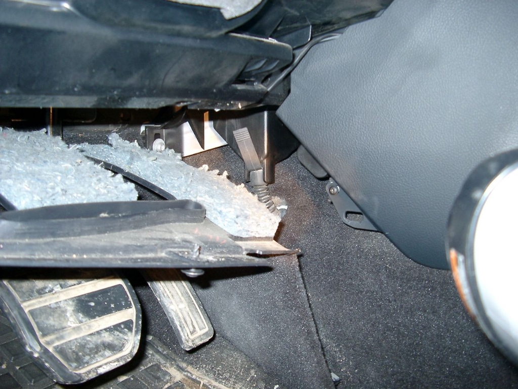

Air Conditioner drain hose disconnected.
I assume the carpet is most wet by the accelerator pedal or on the other side.
If so, per the link below, one or both of the hoses that drains the air conditioner water have pulled apart from the pipes that pass thru the floor boards to outside.
The fix is relatively easy. You pull the panels out on the appropriate side to access the grey corrugated hose and slide it back up to the black plastic mating part. There is one on each side but probably one one has come undone. The jpg below is from my LR3 Miscellaneous gallery section on disco3. There is also a second jpg showing both the drain hoses. http://www.disco3.co.uk/gallery/index.php?cat=15405
