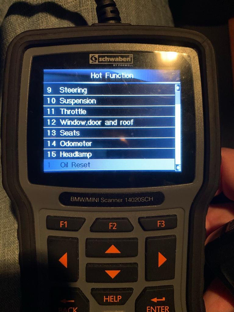

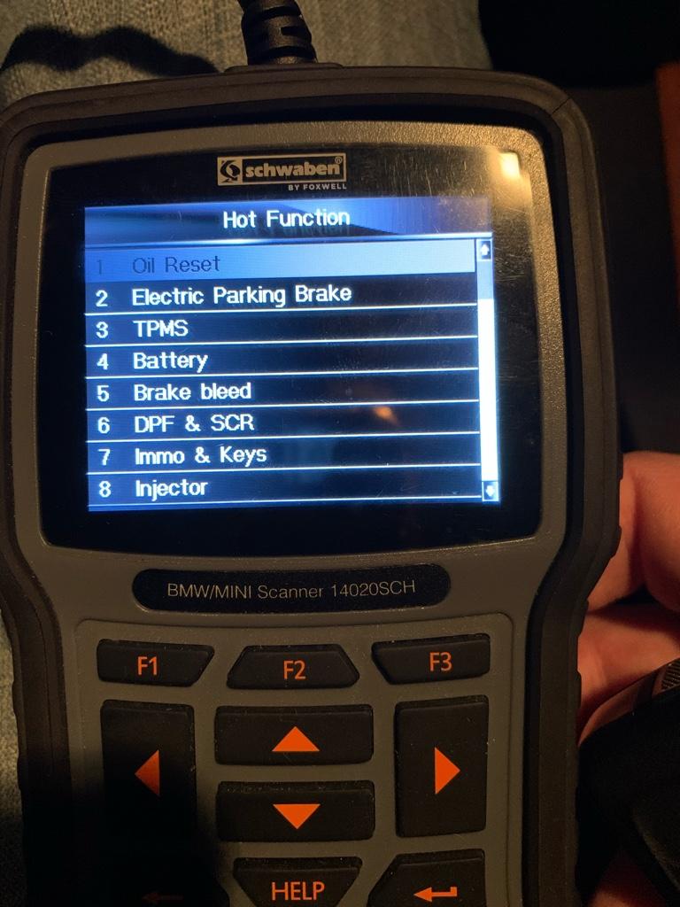

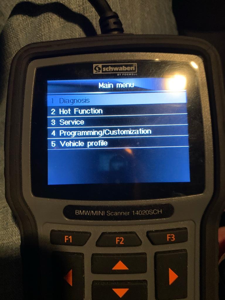

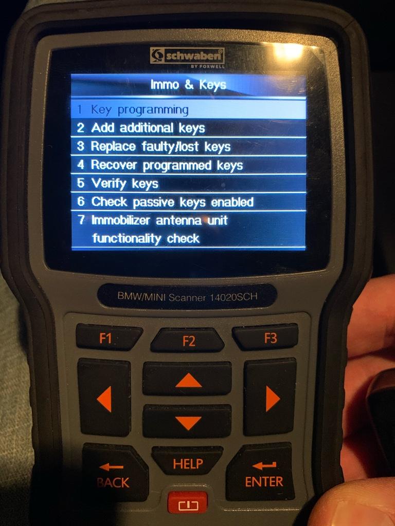

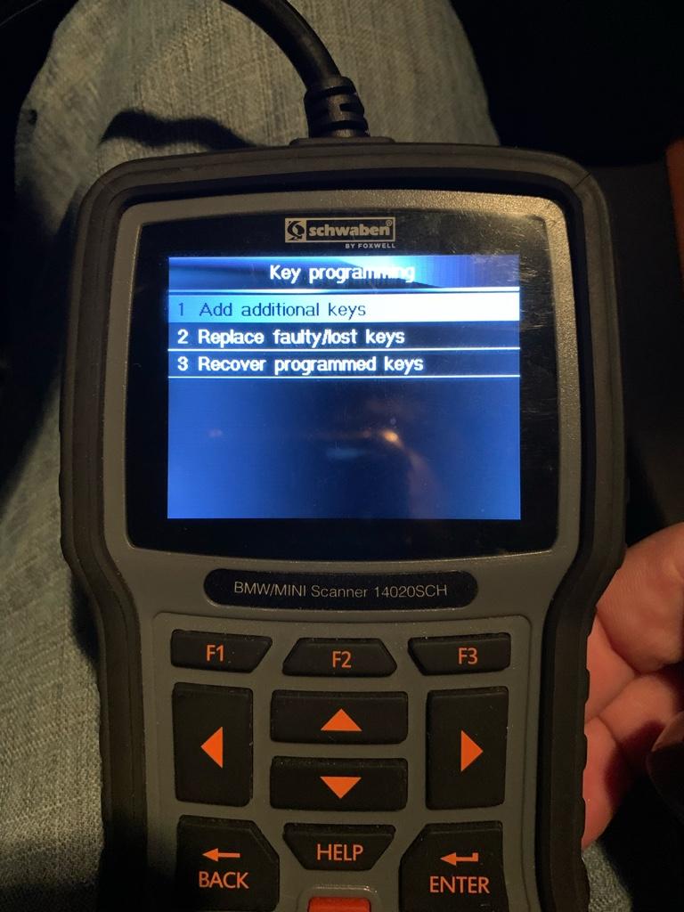

I got a quick second to plug my scanner in and this is what I got, guess I won’t know if it will program a key until I have the key in hand, I’ve seen the option before, doesn’t mean much until you try it. Seems to
be a laundry list of other functions as well. Sometimes it’s like putting together a Chinese made piece of furniture, instructions are there, but you need common sense to figure them out.... lol
