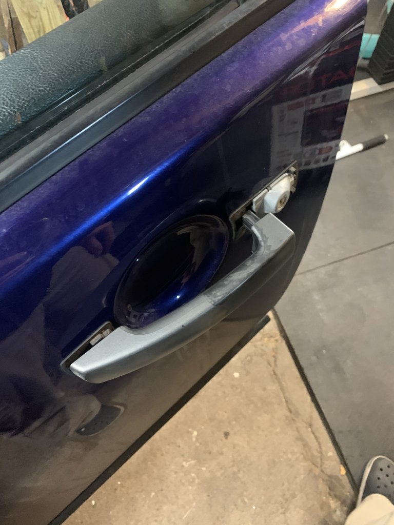

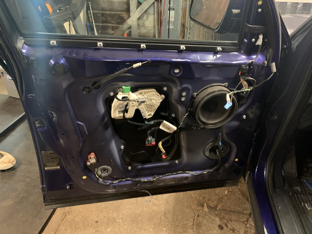

I did test the OEM key in the door handle, it worked, and the alarm went off. Then somehow my outer door handle came dislocated, and I thought I was going to have a nightmare on my hands.... I even took the door panel off to see if I could get a look from the inside. There was no way to see what was going on.... Thankfully I was able to wiggle it back into place. IMG_1448.jpegIMG_1449.jpeg

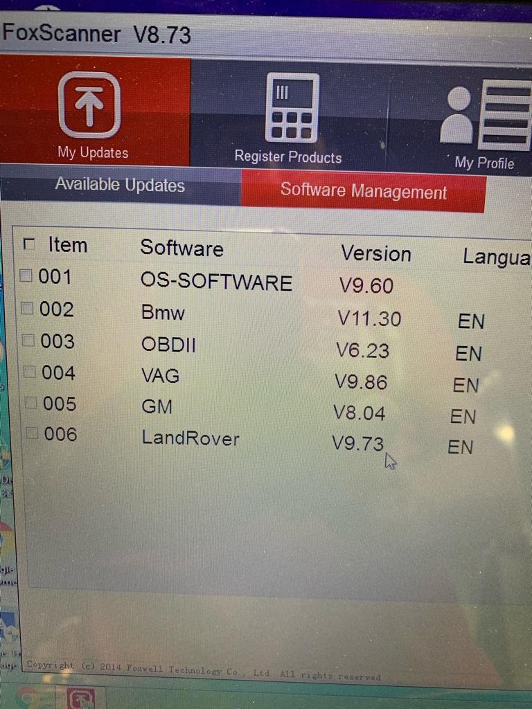

The Schwaben is just a Foxwell NT510 in different clothing. All the softwares I have downloaded are from the Foxwell site. I was definitely impressed with this tool when I bought it originally for my BMW vehicles. I also had the BMW iSTA Software on a laptop, and the Foxwell did a lot of the things the iSTA could do. I think navigating the menu is the tricky thing, some functions are buried under odd sub menus. I paid $183 for mine from ECS Tuning, and the NT510 is listed with Foxwell for $139. Additional softwares are $60 each, so I have just been adding them as I go.

I bought the Land Rover software for the scanner I am currently using, haven't plugged it in to the Rover yet, but for my BMW it had tons of options.
What software version are you running? I don’t have the same menu items on my Foxwell NT510
