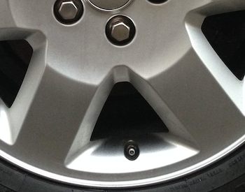

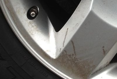

Heavily cropped images showing the before and after. Not great looking pics, sorry.
The first image is actually after the LR3 had been through a wash man car wash, so the top layer of grime is missing.
Worth noting, images may not be the same wheel, but they all looked really similar before and after, so this is representative of what i was dealing with.
