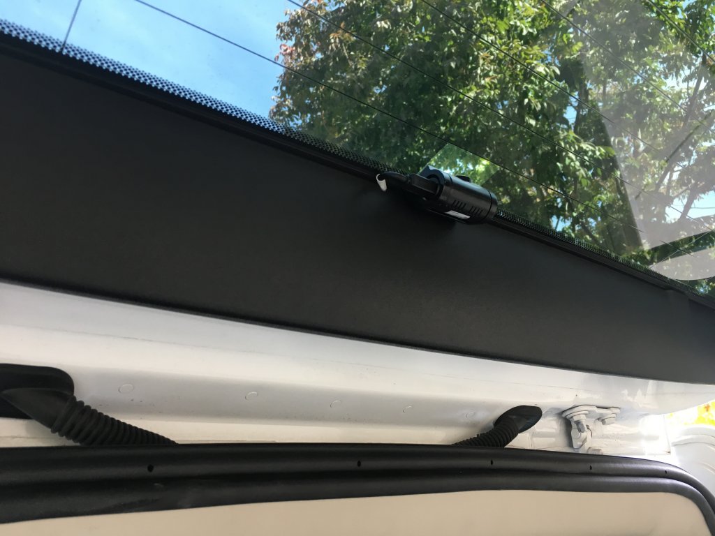

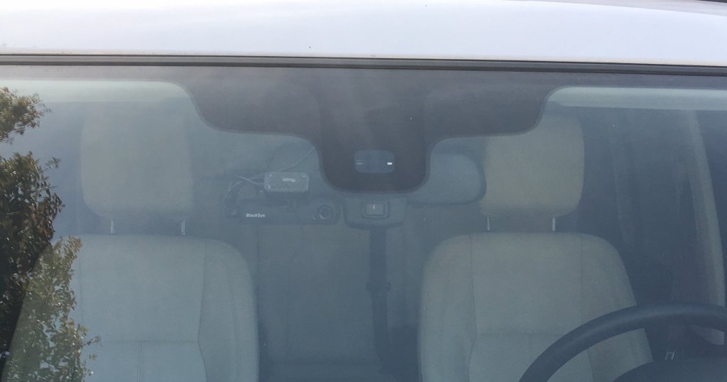

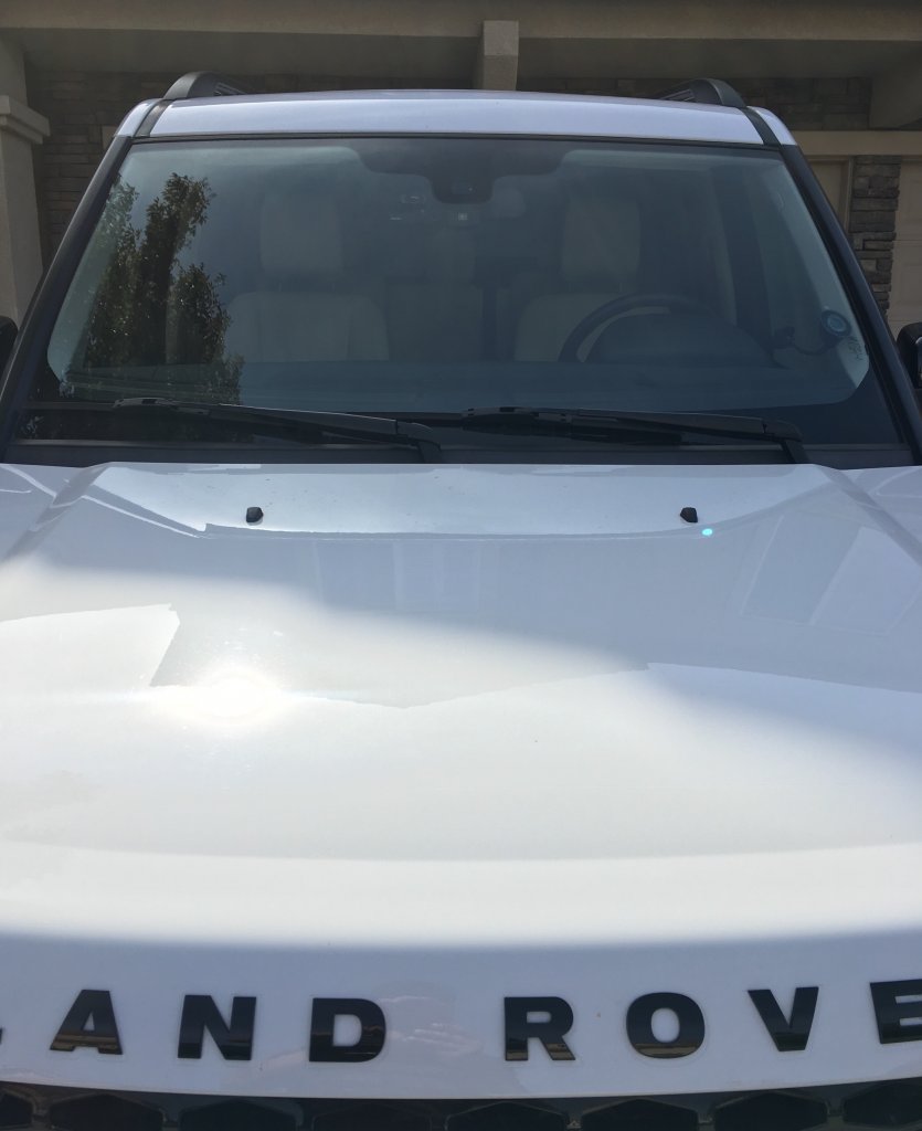

Nice! I installed the Blacksys CH100B dual cam setup in mine. I like the low profile design and the built in voltage management for parking mode. Here are a few pics of how it looks close up and from the front of the truck. Hard to see.
I also included a shot of the rear which turned out clean - running the camera cable thru the existing wire loom was a bit*h but worth it IMO. Note the square cutout in the rear window tint so as to not impact the nighttime performance any more than necessary. The camera field of view was marked out for the tinters before they put the film on.
