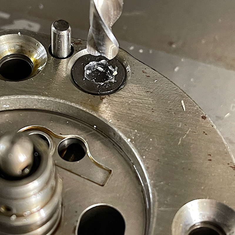

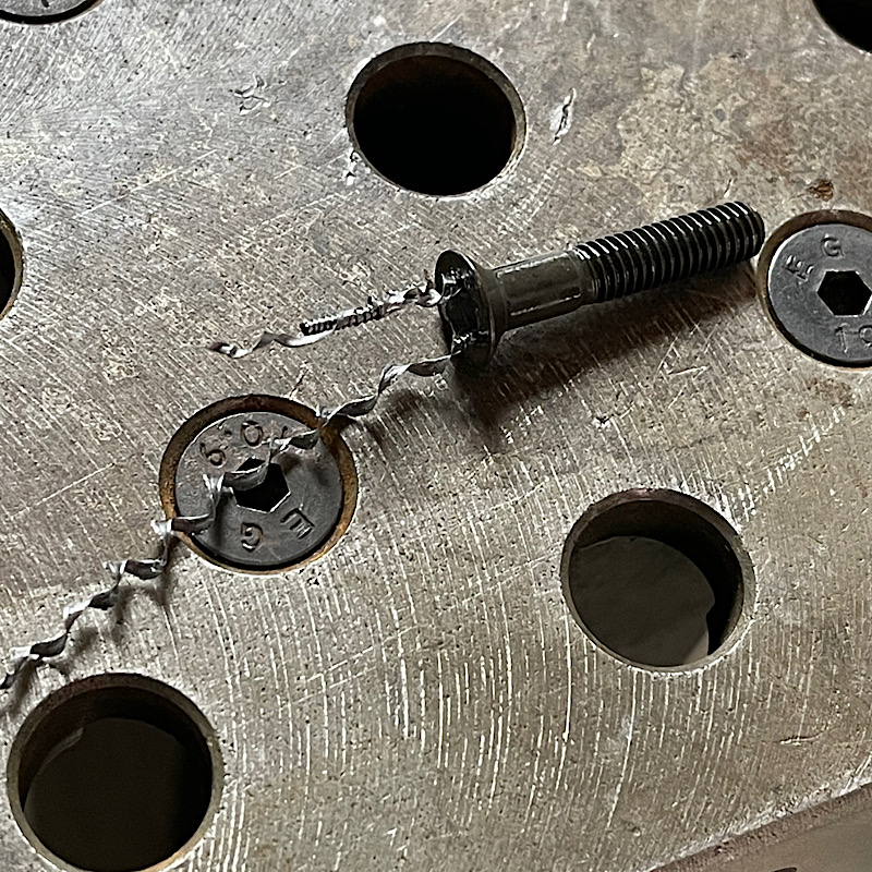

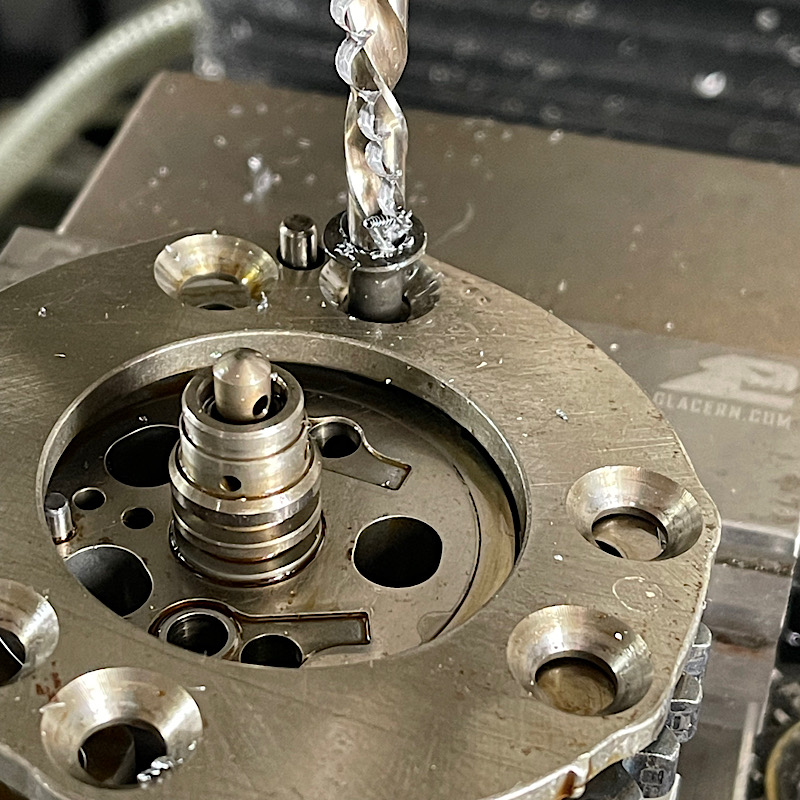

Doing a deep clean on the VVT cam gears and stripped a screw head,
Luckily I was able to drill it out using a left hand drill.
Anyone have a few M6-1.0 x 30 flat heads used in the VVT? V6 and V8 models are the same I believe.
