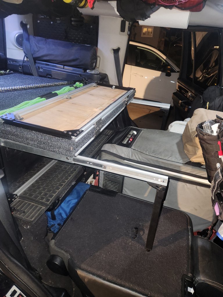

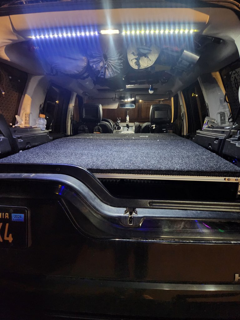

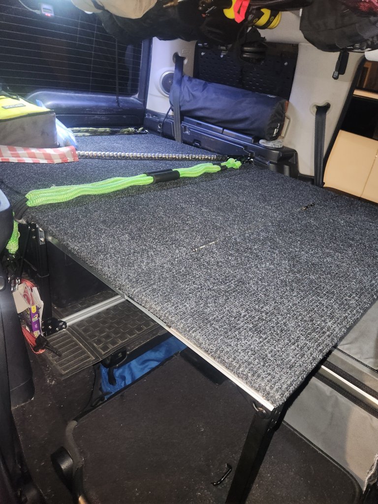

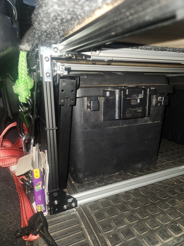

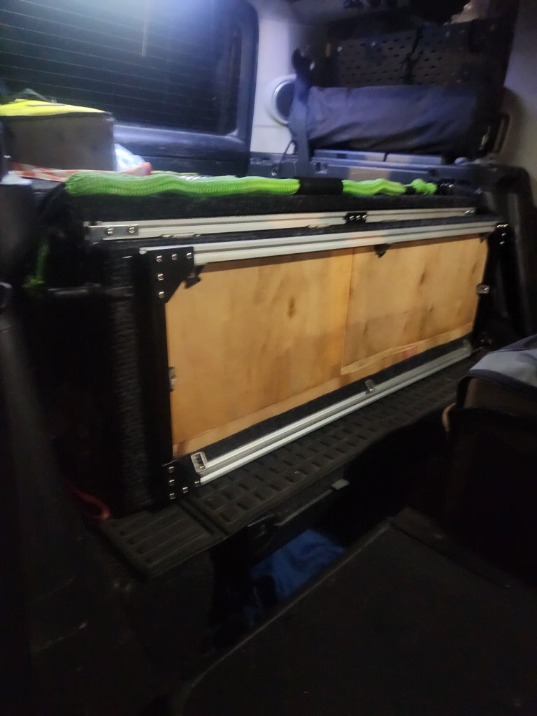

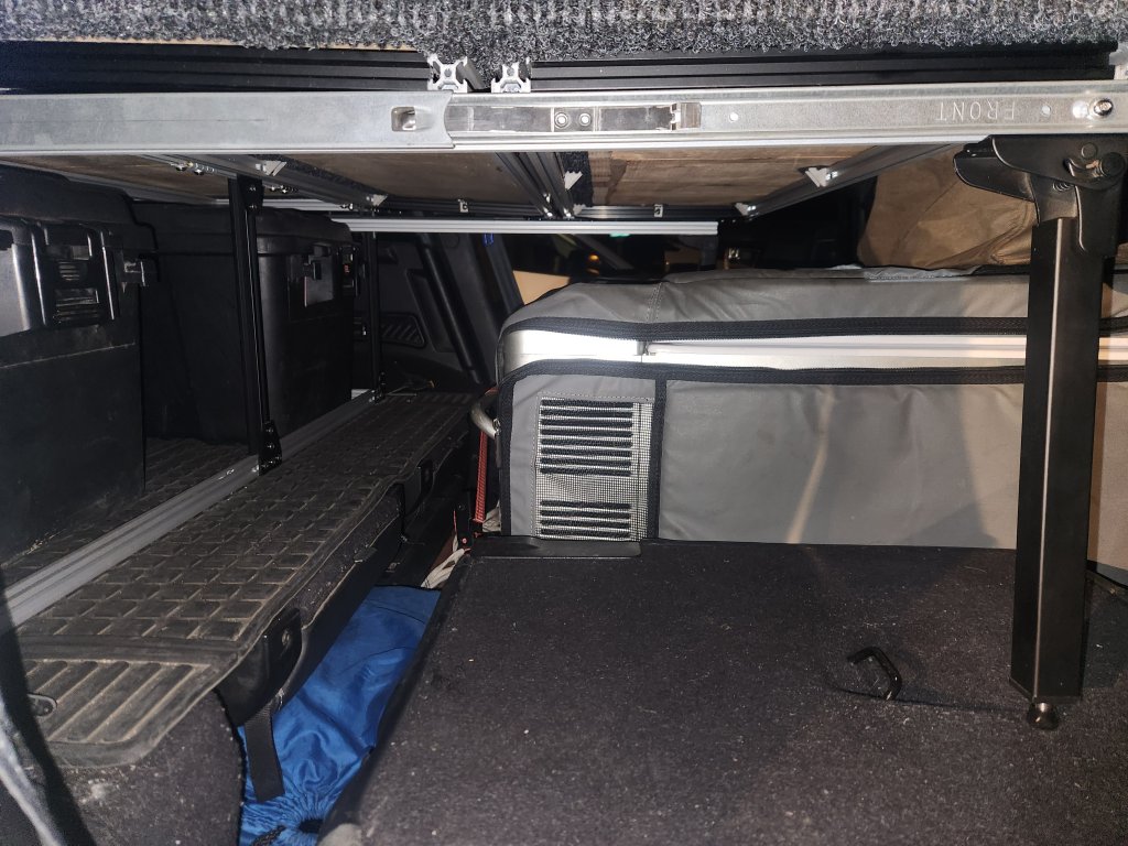

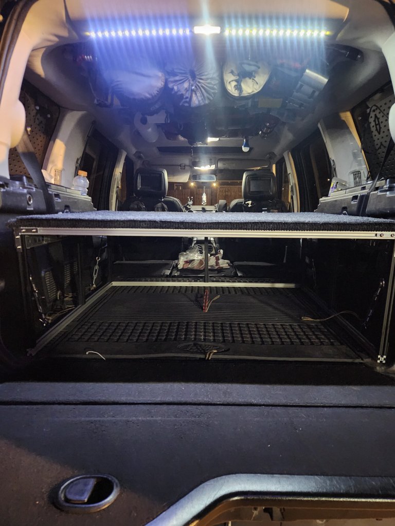

I did one similar to @steevo and @avslash. The rear looks like @steevo without the center brace, so I can get to the spare tire winch. Mine is just tall enough to fit a 5 gallon bucket and some Plano Sportsman bins. The only difference with mine is a double folding platform extension hinge mounted to the platform, and it sits perfectly behind the 2nd row. I used a set of 8020 extrusions on (server rack) slides with pivoting table stand leg to hold up the fully extended platform. 20231215_180048.jpg20231215_180111.jpg

I did one similar to @steevo and @avslash. The rear looks like @steevo without the center brace, so I can get to the spare tire winch. Mine is just tall enough to fit a 5 gallon bucket and some Plano Sportsman bins. The only difference with mine is a double folding platform extension hinge mounted to the platform, and it sits perfectly behind the 2nd row. I used a set of 8020 extrusions on (server rack) slides with pivoting table stand leg to hold up the fully extended platform.View attachment 24410View attachment 24411

2nd row seats folded down and the extended platform folded in half.
Extended platform half deployed with legs extended and fridge access.
Clearance from the bottom of the platform with Plano storage bins.
Fully deployed platform. Don't mind the mess, it was for a quick pic.
Legs retracted and ready to be put away.

Yeah, my biggest gripe about my setup is lack of space with the overhead storage and ridiculously high platform. I'm a small guy and I barely fit up there. I'm a side sleeper and and I hit stuff attached to the overhead storage. I might end up building drawers and lowering the platform. Who knows.
I know I have to go back and blue loctite hundreds of screws, but this was my first iteration and I wanted to revise it down the road. I really like what @avslash did, he used square tubes and quick corner connectors that didn't require screws. Now that's a slick setup.
