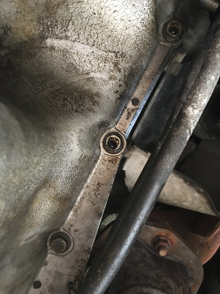

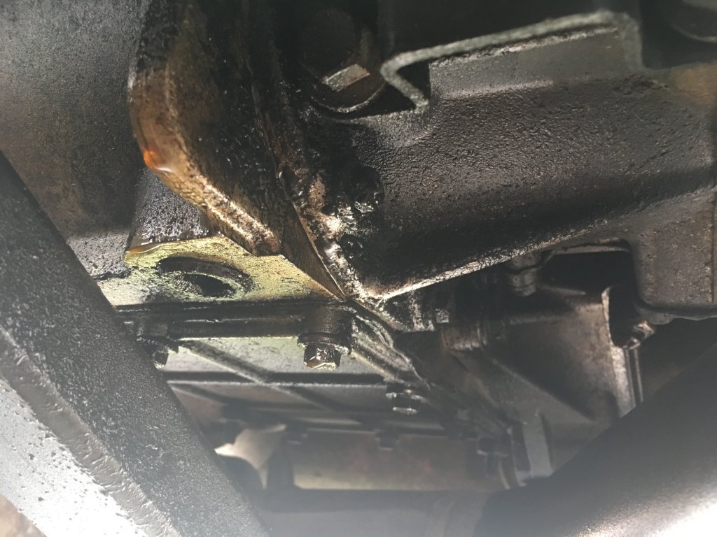

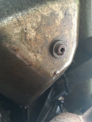

I'm new to this site and have recently acquired a 2003 Disco 2. Once I parked it at the house I noticed it was 'Leaving it's mark' as these vehicles seem to be known for. I'd like to nip these leaks in the butt now before I decide to take it on a longer trip.
I think it's ready for a new oil pan gasket as I can see oil coming from some of the bolts on the pan. I'm not sure how to approach what looks to be gear oil leaking from the "transmission pan?". I've attached some pictures. Your feedback is appreciated! IMG_1050.JPGIMG_1048.JPGIMG_1047.JPG

Power wash it to see where the leak is.
