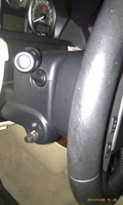

I just bought an LR3 2005 HSE white with tan leather, this is my first post here and my first land rover, i have some questions if you can guys help me,
- i want to know the button in the attached pics is used for what? below the left and right turn

That button is aftermarket. I have seen an after market ride height adjuster that look similar but not sure what yours would be.

That button is aftermarket. I have seen an after market ride height adjuster that look similar but not sure what yours would be.Does is turn a dial or is it a push button? It could be one of these at http://www.llams.com.au/

there are 2 turn buttons, the first one with the white line if you turn it left the lamp will go orange and right it turn red with left or right signal flasher go on for 1 second with weird sound. the other turn button i don't know for what.
