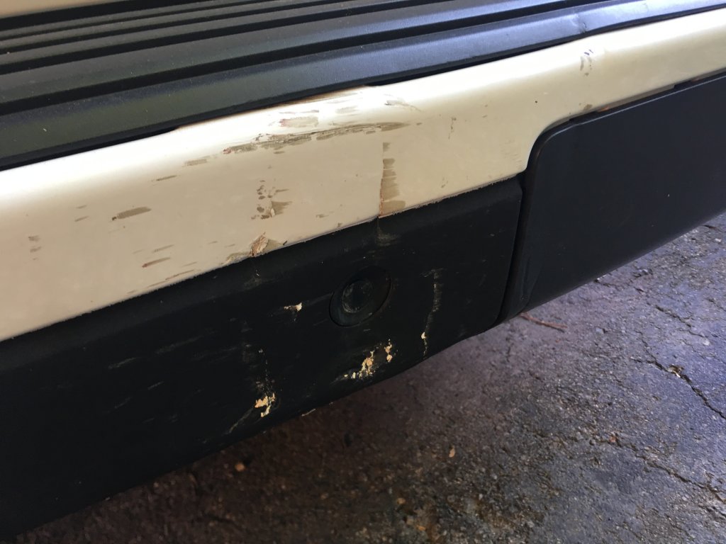

I honestly don't know. After I saw the vehicle I got the Carfax, there was a minor rear end accident reported in 17 and it went to a shop after that so I assume it's a more recent dent. The tailgate and glass panel look good though. HEre's a pic of the rear bumper dent.

Do the rear parking sensors work?
there is an interconnection in the wiring between the parking sensors and the camera. I know this because when I had mine disabled when I originally installed my steel rear bumper, the camera did not work.
The shop had to plug it back into their computer and we do something to bring the camera back online.
Interestingly, when I disabled them with The Gap tool this did not occur.
^This. If a parking sensor fails it will also cause the rear camera to go out. I have had a parking sensor fail and experienced this. Then I had the opposite and the rear camera died and needed to be replaced. And now I get the "rear camera unavailable" message whenever it rains so I can only guess that another parking sensor is shorting out.
