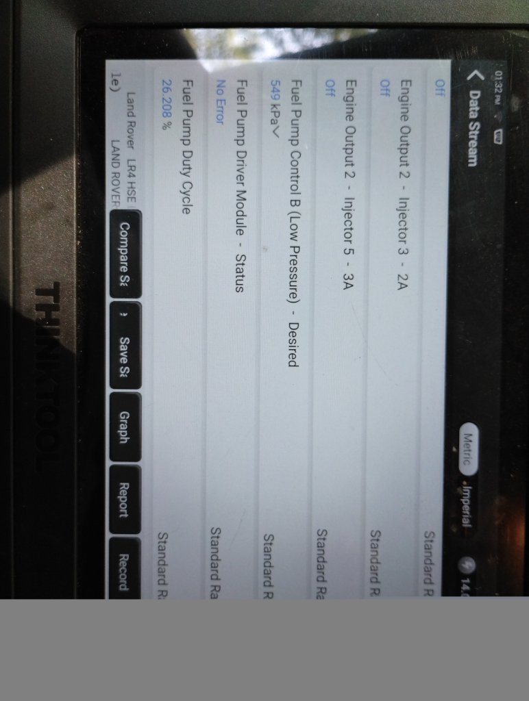

@richord Wondering if your icarsoft can read live values for fuel injector pulse width modulation or fuel pump duty cycle on your 2015. GAP tool cannot. I’m thinking about getting another tool that can read some of these live values parameters missing from the GAP tool, but not sure which ones might be good to try.
On my 2015 I can see the low pressure fuel pump duty cycle and pressure with my Think Tool. I can't see the fuel injector duty cycle.
