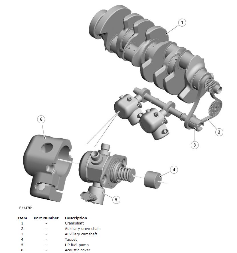

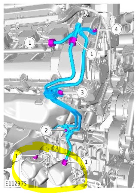

Regarding the fuel pump, yea, I could see the noise being due to that. Where are the pumps physically located on the engine? I ordered the shop manual for the truck but don't have it yet.
Thanks again,
Rich
They are both on the right side of the engine under a cover.
Here is a pic from the workshop manual (circled parts)
Now that i look at the picture, i'm sure it's the tappet that is making the noise.

Gotcha, cam driven pumps. The noise totally does sound like a bad valve lash adjustment or bad hydraulic lifter, and from the image showing the design I agree with you completely this definitely could be the source. I'll take a better listen in that area to see if I can confirm that is the source.
