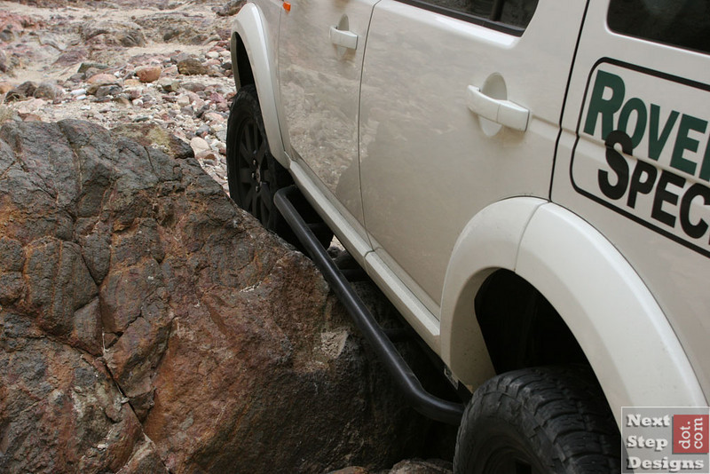

I use the RS stage 3 sliders and wheel mostly in rock in Arizona, etc. I have found that your comments are correct about the standoff tubes getting in the way when sliding over some rocks. I have also felt that the standoff tubes affect some the the clearance when trying to fit through rocks.
However, when I look out the window and see that rock held away from my door panel by that tube I start to like the tube more :biggrin:. In fact sometimes the tube has kept me far enough away from larger rocks and protected my doors.
I'd like to see the low profile option in action sometime!

Craiglug, those standoff's definitely have their Pro's and Con's:
Pro:
Con:

Basically, everything inboard of the tall pylon mounts is where the sliders cover the frame. The "batwing" shape of the plate is the contour of the inside face of the frame tube. The sliders don't physically attach to the frame itself (although my first pair prototypes did). Simply having the stiff plate in contact with the frame prevents any sort of overtuning force that would result in a cantilever load situation, such as my photo above with me stuck in this pinch-rock scenario:
