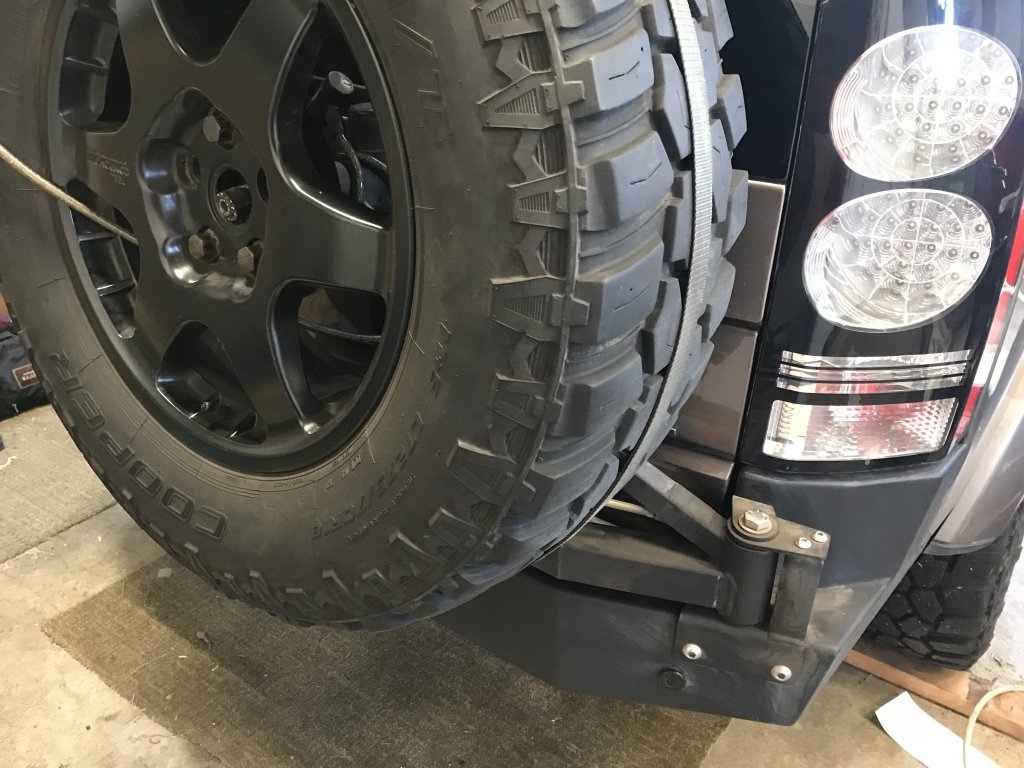

Amazon camera, mounted to the spare rack with a piece of heater hose so it pokes out of the center of the spare. You can see the vinyl tube encasing the cable where it joins the bumper at the hinge point at lower right.
That's a solution that works for sure, but I do run a trash bag on my back, and I have a tire cover on my spare to boot. I think I'll have to find something to mount on the jerry can holder which will house both the camera, license plate, and light.

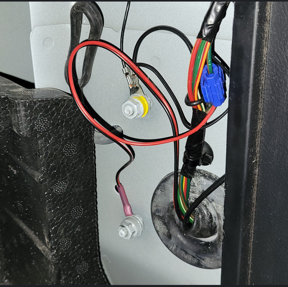

I tapped into the backup lights in the rear quarter panel to power the camera when the vehicle's in reverse, but if I was going to do it again, I'd tap into the power provided to the factory camera so it would stay on a bit longer.
