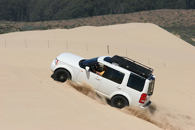

Todd, I find your tips to be interesting, because they are almost the exact opposite of what I recommend! I suspect it has to do with the types of dunes we run on. Your photos all show flat flat flat dunes in transport mode, whereas I am always tackling the hill climbs and bowls for pure fun. I can see the value of your approach, though I disagree on the issue of low range. You can safely go over 50mph in low range in 5th gear, which far exceeds your 30mph limit in raised suspension mode anyway. For me, having that abundant available power with the low range gearing is a great way to avoid getting stuck if you loose flotation!
