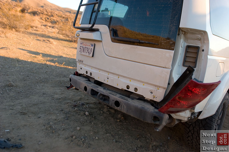

The rear bumper assembly is remarkably pliant. It probably just came off the clips that help hold it on. you need to remove the two screws that hold the rear lights on, then a number of fasteners around the back of the wheel well, then a few screws under the rear lip of the bumper and then the whole assembly should be able to be pulled off.
I was able to fix this on the trail:
Looks pretty ***** without it!

Thanks for sending the link for the bumper pictures. You were right, there really isn't much to the rear bumper and it was just a case of striping it down and clipping it back into place. I did notice that some of the panel clips were damaged beyond repair and I now need to order some new ones. Do you have an online store where you buy from or do you use your dealership? I lost the tow hook eye cover completely and also need to a hold of a new one. Thanks again for the help, if you have any tips on where to get the panel clips from it will be very much appreciated.
