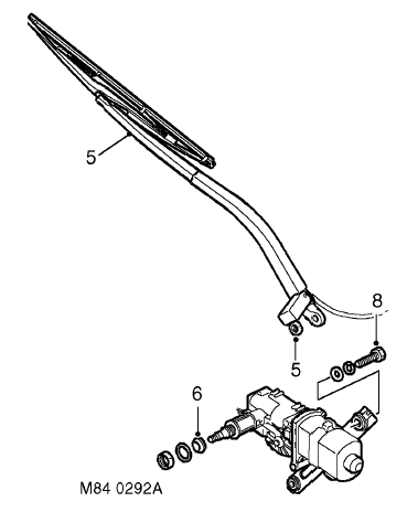

Discover II '99 owner. Trying to avoid dealership for rear wiper motor replacement. May be over my head with this one. I have back door panel and speaker removed. How do I remove wiper motor?

Motor - wiper - rear screen
Remove
1. Remove spare wheel from taildoor.
2. Remove tail door trim casing.
+DOORS, REPAIRS, Trim casing - tail
door.
3. Remove tail door water shedder.
4. Disconnect washer tube
5. Raise nut cover, remove nut and release wiper
arm.
6. Remove spindle nut and flat washer and
discard rubber seal.
7. Disconnect taildoor harness multiplug from
wiper motor.
8. Remove 2 bolts securing wiper motor to tail
door.
9. Remove wiper motor.
Refit
1. Position wiper motor to door and secure with
bolts.
2. Connect tail door harness multiplug to wiper
motor.
3. Fit rubber seal, flat washer and spindle nut.
Tighten spindle nut to 3 Nm (2.2 lbf.ft).
4. Position wiper arm to tail door and connect
washer tube.
5. Tighten wiper arm nut to 20 Nm (15 lbf.ft) and
fit nut cover.
6. Fit tail door water shedder.
7. Fit tail door trim casing.
door.
8. Fit spare wheel to tail door.
