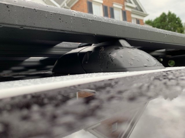

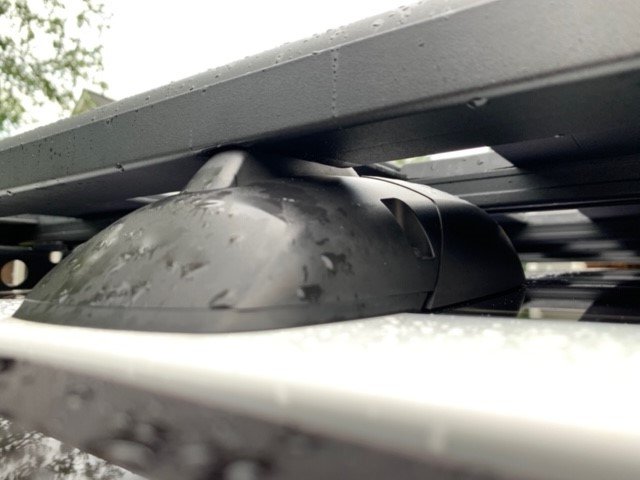

Thank you for the quick response. For anyone interested this is contact point we are referring to.

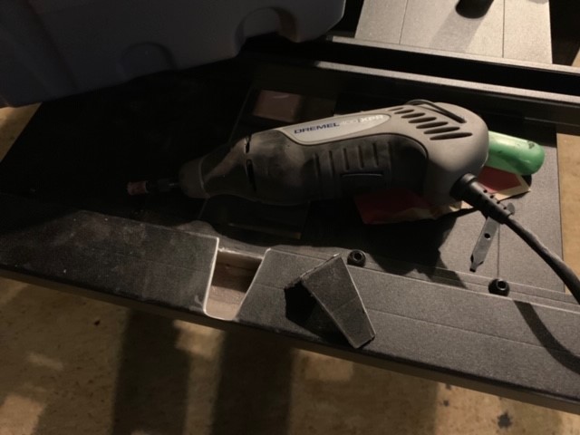

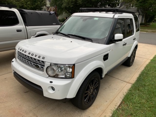

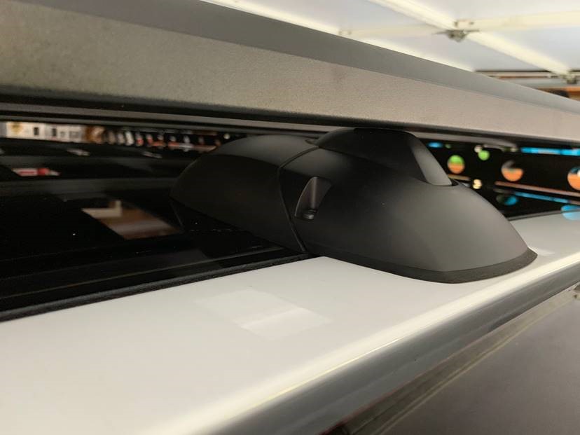

Update: I pulled the platform back off last night and cut a notch in the underside of it to clear the antenna. With the goal of keeping the rack as low as possible I wasn't keen on the spacers as an option. Fits like a glove now!
