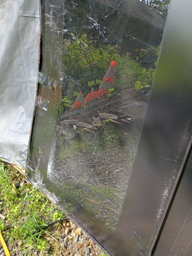

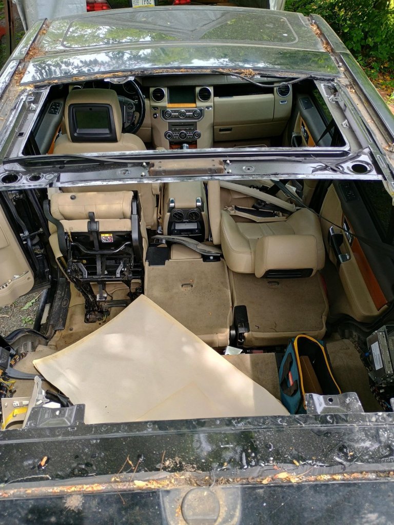

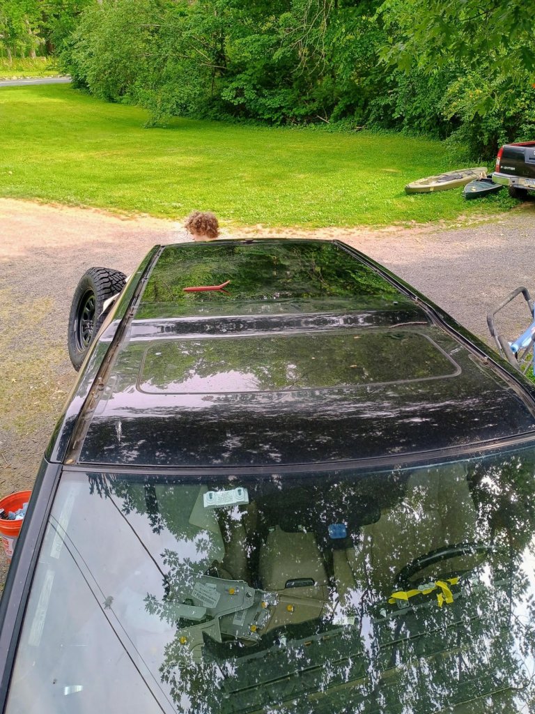

Indeed it is, hardest part for me was getting the glass. Second pic was the shattered one that came out. Tree fell on it.

1700 from dealer was best price I could find. $200 for used one was much better. I fully understand why no glass guys around me wanted to do it.

Ha, local guys wouldn't entertain doing it at all. Said they don't do them anymore, too much hassle. Disassembly and prep was the hardest part ( recovering headliner tomorrow). Bought battery caulk gun and eurathane tubes. Dropping it in was pretty easy with three people
