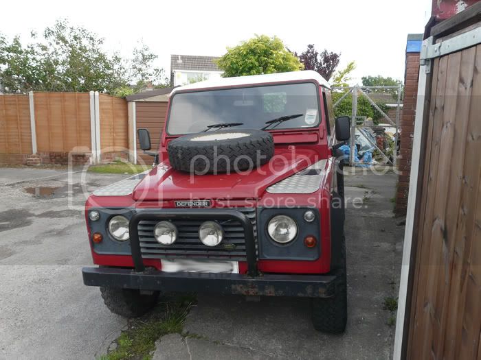

I've not owned my Defender that long but have put in an effort to get it looking the part.

About my landrover:
Bought this last year and it was in a bit of a rough and ready condition. The RAC inspected it and the engines a good-un.
It's got the 300 TDI engine in it (despite being a 2001 model) so I know it's not got the potential of being a nightmare to work on compared to the newer Td5.

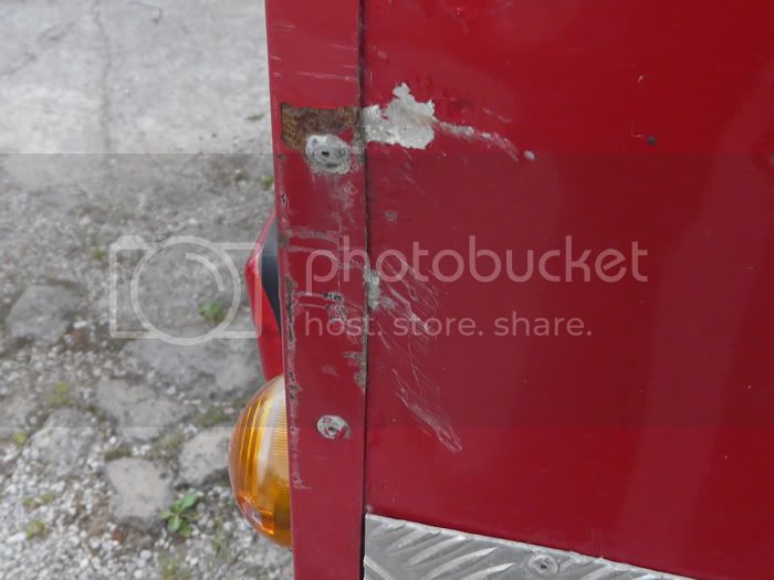

The bodywork was a bit rusty on the steel sections and needed some mostly cosmetic work:

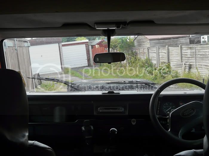

Nice views, you feel like master and commander up in the cab
Bit 'o damage here:

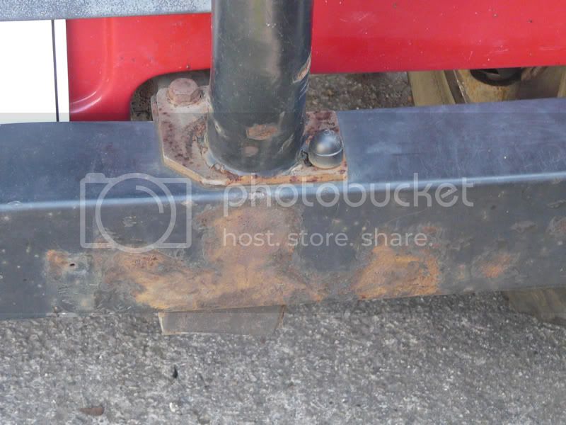

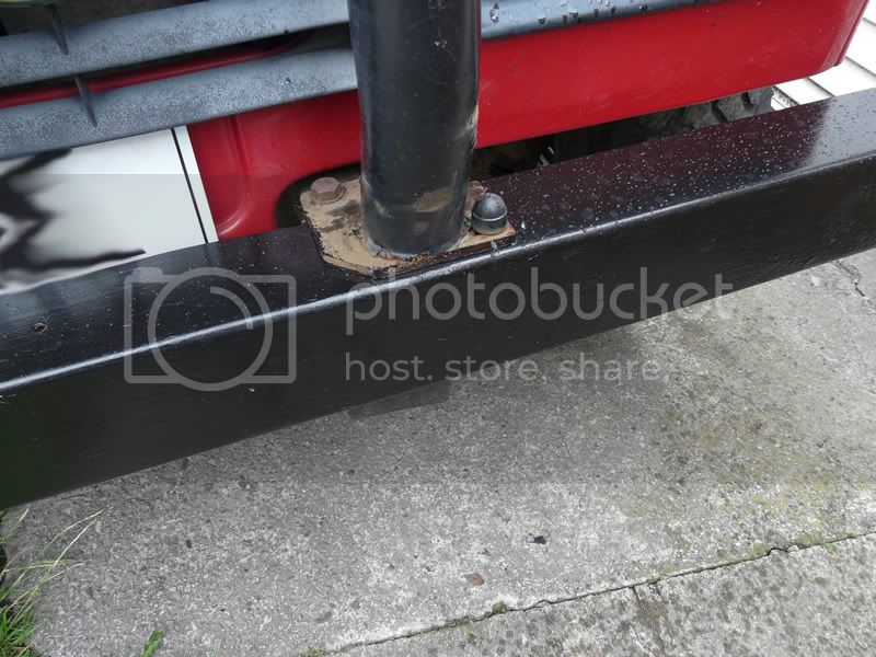

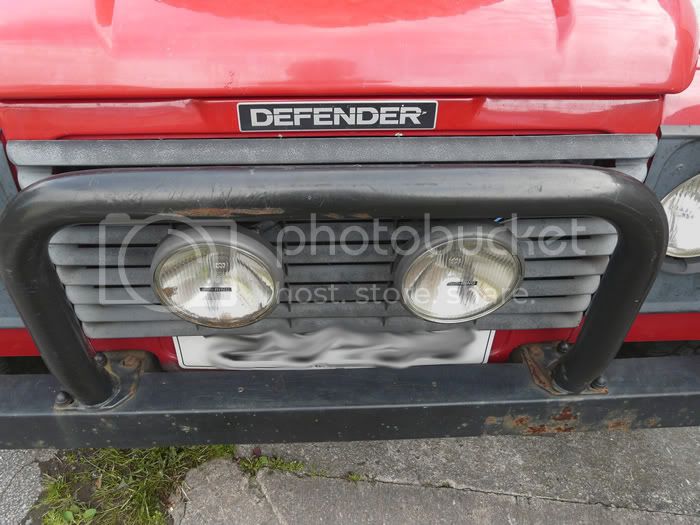

As you can see the back and front bumpers are pretty rusty looking and faded. The rust isn't deep though and is mostly surface stuff.
So with a grinder and a smooth disc I set about grinding down the worst rust bits and sanding down the rest.
This done I used a few coats of rust eater. Once this had dried I started applying black hammerite paint. This stuff is quite expensive but it is specifically designed for metal application and doesn't need any undercoats. You just slap dash it on. You know the saying 'If you can p&ss, you can paint' :D Only kidding there painter-folk :)

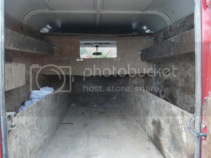

The landrovers interior was a mess from its previous owners.
It was covered in this fine cement dust that would not sweep out nor wipe out easily.
In the end I soaked up as much as I could and bought some green exterior wood paint and gave it the real slap-dash treatment :)
It's green green green inside the rear cargo area now.
From this dusty place:

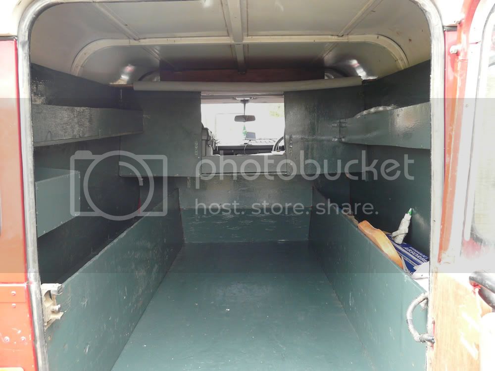

To this:
No longer is dust ever present and getting on clothes and kit etc. With the gloss finish on now any muck or debris just wipes off :)

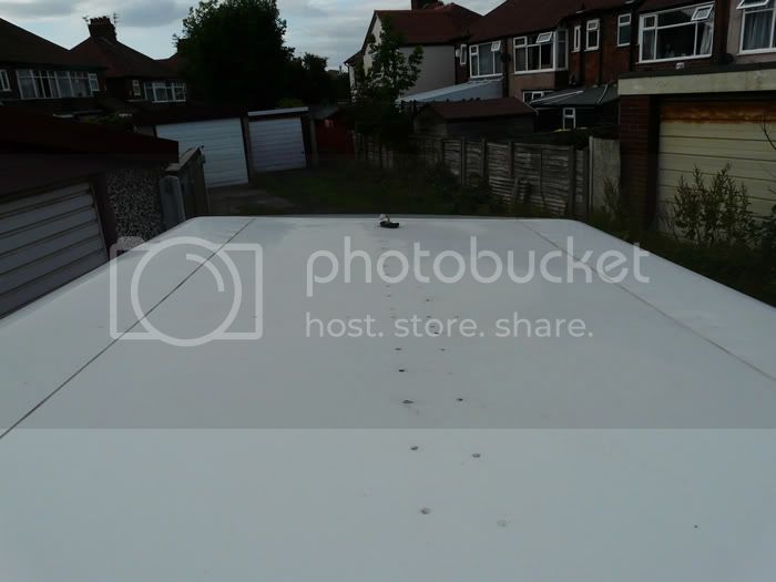

Now a bit of a ****** with Defenders is that they are prone to leakage. Mine was no exception. On the inside of the passenger door and the drivers side along with the cargo door it leaked. Drip, drip everytime it rained hard.
If you left the vent flaps open and it rained there’d be leaks from their too but closing them prevented that.
It was time to fix the leaks.
The drivers side leak I fixed by treating the metalwork where the rubber weather seal joined with some rust eater and touch-up paint.
The roof was where the real work was needed though and I needed something to match the white roof.

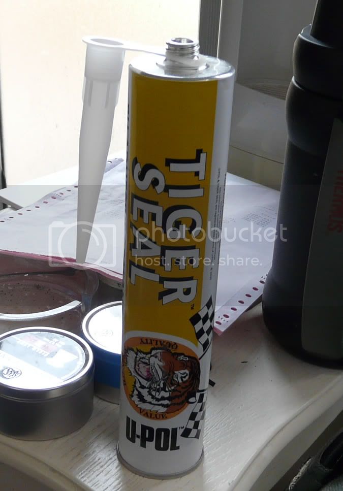

My local mechy Tom advised me that the best stuff was the window sealant used by double glazing firms. Car accessory places also supplied it.
After a few sagas I sourced some of the stuff – Tiger Seal!
I was warned not to tarry when applying it. Once it the stuff dries, it grips like a tiger and there’s no going back.
Well I attached the grease gun frame and it didn’t work. Not good as it means I’ve no way of applying the sealent to the roof seam 
In the end I just cut the neck off and stuck a big ole thin rod in and pulled it out. Then with some rubber gloves on I just finger applied it into the groove.
Took a while let me tell you but after about an hour I’d just managed to get both sides plus the cross groove done when the stuff set hard!
No leaks from the roof now, just a little bit from the door seal near the ground. But that’s nothing really.
