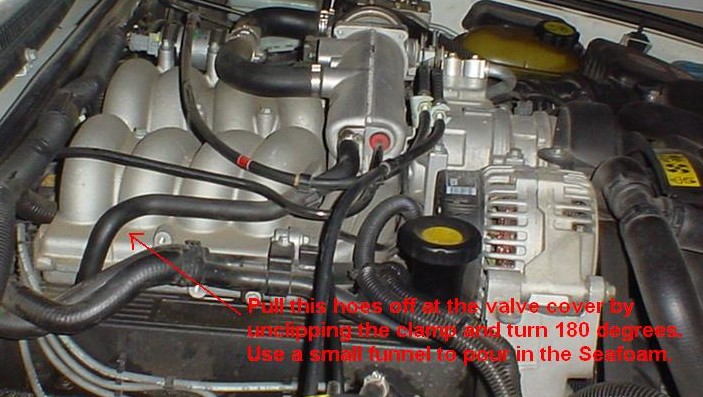

The picture that guided me...from the replies posted thus far...it does appear I may in fact be an idiot.
Trial and error has worked for me in the past with my Jeep, however, the Disco is a totally different animal.
I am in no way upset with any guidance received from this forum. To this date everything else I have learned from here has been highly useful and helpful.
If I am an idiot, please spare me the lambasting. The money I will be giving the dealer is pain enough...

MToomey,
Good picture and advise. You can also use the small red vaccumn fitting shown in the middle/top area of your picture. I just attach a section of vaccumn line to that knipple and put the other end into a bottle of SeaFoam or 24K. I do meter the flow using a pair of plyers so the fluid enters the manifold slower, usually over 2 or 3 minutes. I found by doing this you get better results, won't stall the engine and or throw a check engine light.Take care,

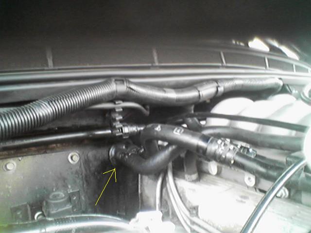

Well, here is a picture of what I did. I tried pulling the hose off where the arrow points. Yeeeeaa, heater matrix. Don't touch.
I will use the further guidance in this thread to properly use the Seafoam and maybe I wont spend another $1400 on an amatuer mistake.

Ouch... didn't know it was that fragile there... thanks for the info.

Worst part of it...
The estimate was for $1500. Mel from service called me and was like good news. "We found out your heater matrix didn't need replacing, just the hoses. So you saved about $100 on the whole thing."
Ok. If the heater matrix didn't actually need replaced, how did I only save $100? You guessed it...$800 worth of labor to figure out that the heater matrix didn't need replaced.
HELL! REPLACE IT! Whats another $100?
