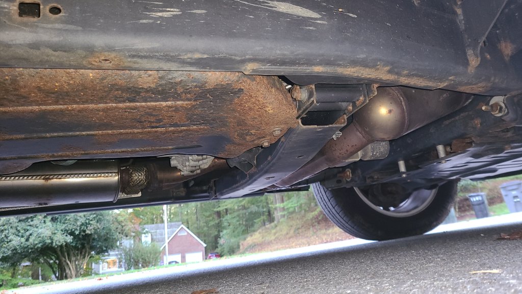

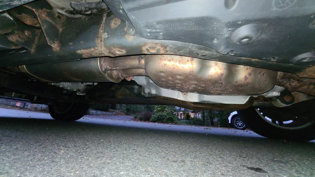

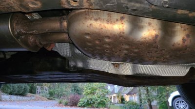

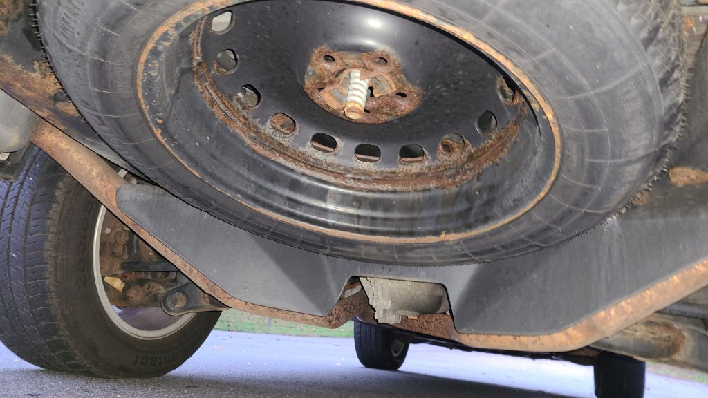

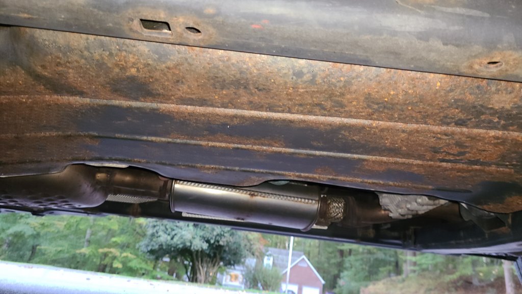

- Rust on the underside but not sure if its more than normal? Car did spend 30k miles in Canada [photos]

Interesting that it started life in Canada. Also, is that the ipanema sand color? Looks more like a 15-16k truck but I could be wrong.
1,403
That is Ipanema for sure, same as mine. What this has taught me is that I need to sell my Canadian vehicle in the US...
Looks to mostly be surface rust but I would have it thoroughly inspected. I agree that is a $15k'r Just point at the rust..

Rust looks fine, the body frame is known to be really solid and surface rust common.

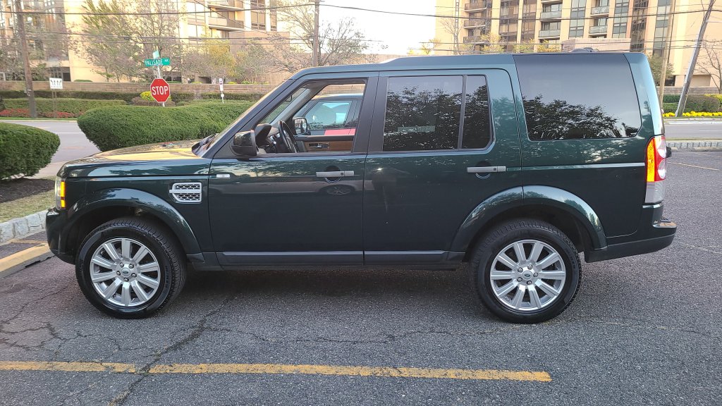

2012 lux with 110k. They want 13500. Its green which is my favorite color but its got some body damage (pic attached). And after raising the suspension to offroad and setting off on the drive, the rig threw a suspension error and would not reduced height to normal ride level. Warned not to go over 30 mph because of the added height. It did drop down after turning the car off and back on and lowering before driving off again.
Any thoughts on what component it failing on that? The owners dad owns a truck company and is going to try and pull the code for me.
