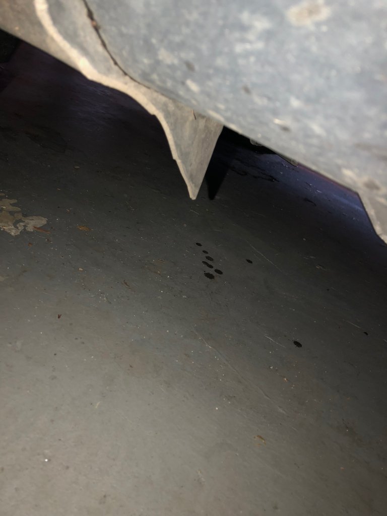

well, i suspected them being bad, threw it up on the lift and couldn't see anything. couldn't move them, too heavy. but on driving there was a little wobble at high speed braking and there was a clunk from light braking while going down a steep hill and over concrete imperfections. then this showed up on the garage floor inside the drivers wheel about 6 inches. HMMM. 48k miles. so it is going into the dealer for that... View attachment 7851
Update. Took it to LR encino. They were bad and they are covered under the warranty because they are not removable like in some other models. According to the service manager. Alignment also covered under warranty. Pretty pleased about that.
