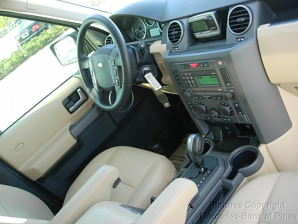

tzinsli - now how in the heck did you get your starmate sirius unit down in that area without exposing any wires? How does it get power?

or how would someone do this without exposing any wires? did they drill holes?

Power comes from left aux. power socket. A small bit of wire shows, but is pretty unnoticable.

so where did your run the aux or the antenna cable? I dont see either of them... how did you hide them so well? also is there any other way I can power the sirius other than the 12v cigarette lighter slot? cuz I plug my cell into that and I really dont want to have to get an adapter and have both in the same slot.

The only other wire I have is the antenna cable. It runs in the dash junction just below the power outlet and continues along under the steering wheel. I'm using FM, no Aux. cable.
