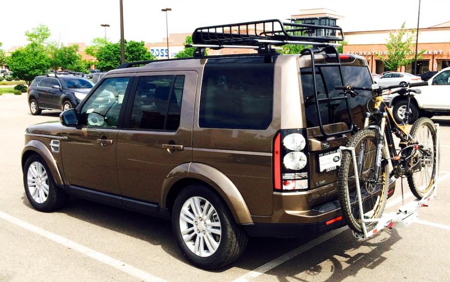

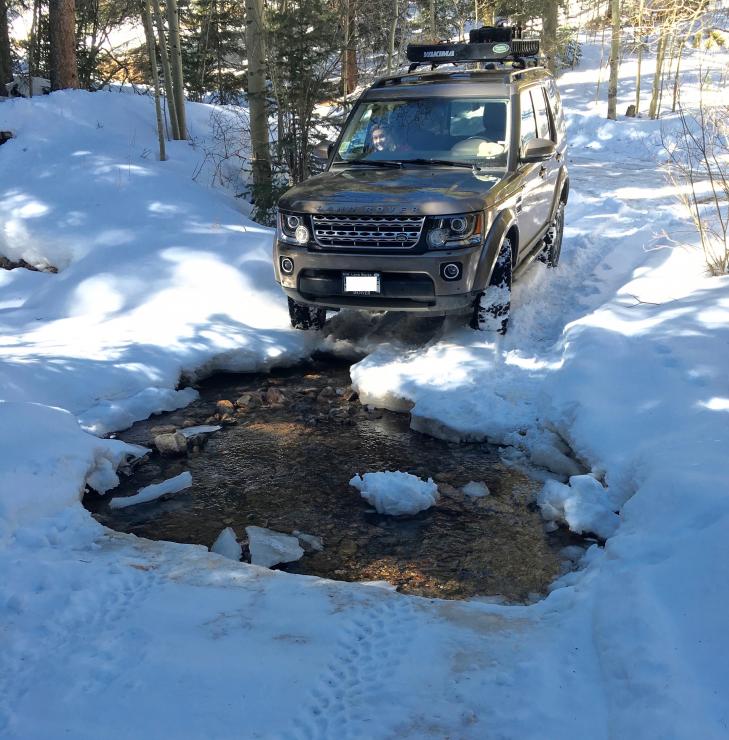

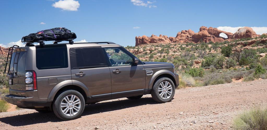

I use Yakima crossbars and a Yakima Load Warrior rack. Though not a picture of the rack specifically you can see it on top of my truck from a drive I did today.
You may notice in the picture that I started with a set of Thule crossbars as Yakima did not have a fit kit for the LR4 at the time. But I found the Thule bars to be too complex to install/remove. I found the Yakima's much simpler so I switched to them (and still have a lightly used set of Thule's taking up space in my garage!) I also started with a regular size Yakima Load Warrior. I added the 18" extension last summer when I needed to put my spare tire on top to accommodate an aftermarket trailer hitch receiver (another story).
I am very pleased with the Yakima setup. I tend to leave the bars on all the time now. But I usually pull the rack/basked off during the winter. I prefer the bars that can extend beyond the "towers" as this gives me more load carrying options. If you are only interested in skis then this may not be of interest.
I don't know if the Yakima bars (I have the aero bars) are more or less expensive than the OEM LR bars.
