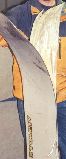

For what it's worth I have used a ski rack similar to this design. I rented a car in Denver and was driving west on I-70 out of Denver, right where that overhead sign is that warns for inclimate weather, when the board flew off the car. Either the people at the rental place did not install the rack properly or the design of the rack could not withstand the stress of the highway speed coupled with the strong winds. Either way, my board was toast. If it were me I would go with a ski rack that allows the board and skis to lay flat, or parallel with the roof. Also get one that has metal arms that clamp down over the board and skis, and also locks. I think over time you will be happier with this type of set-up.
P.S. The rental company paid for a new board and bindings...
